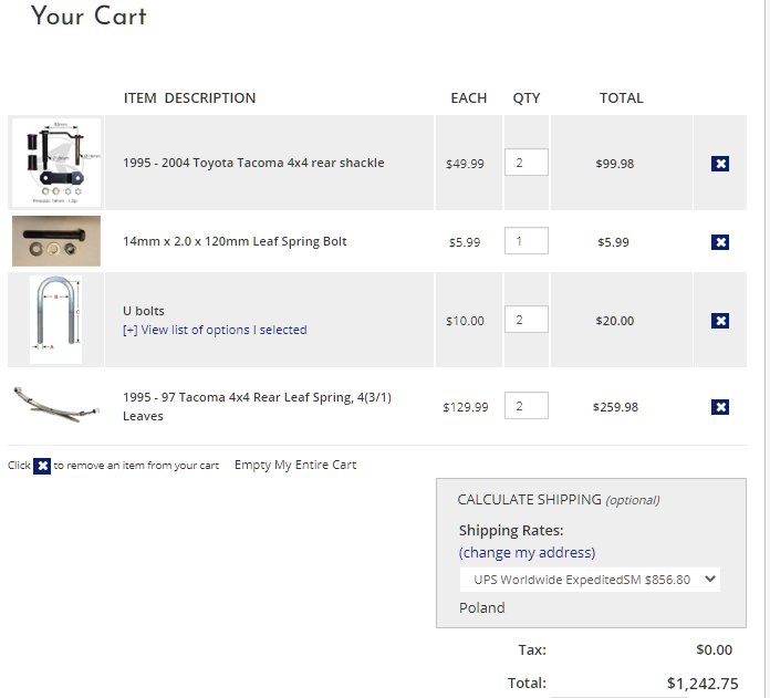

    Juts talked to a gentlemen in general. He said that while 4(3/1) will give some lift but no more than 1/2 inch, so I will be good with my original shocks.
    Poland was not on the list on the web because it was not needed before :), but they will ship to Poland. He updated the list and I am a bit stunted about the shipping cost to Poland being almost doubled comparing to the our neighbor Germany (100km away). I was expecting actually something close to 400 USD like Rock Auto has via FedEx.
    I have prepared the following shopping list:
    Now I need to swallow that shipping cost. I know customs will add 23% VAT to it, so it will be close 1500 dollars. :ballchain:

    You have no spring shops that could make new leaf springs gotta be far cheaper then $1500.00
    Even if you had to move hangers to make them work
    only doing one spring it will sit different .

    I'm with Wyoming - for $1500 I'd make something from a more common local vehicle work. Even moving hangers if you had to....and even building hangers from scratch and purchasing a welder you'd probably be cheaper.
    There's gotta be fab shops there -- I know Poland puts out some really decent cutting tools for machining, so you guys can build things!
