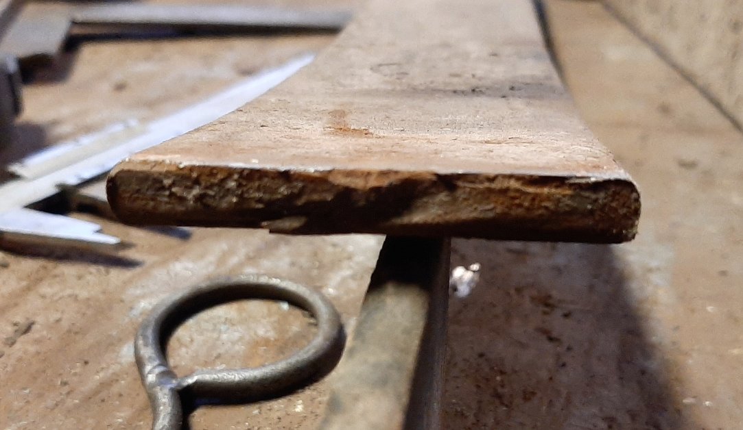

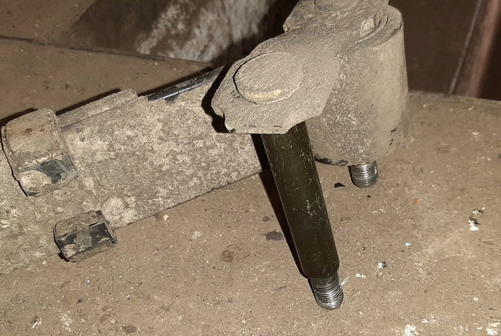

    Here is the happy ending to the story. I drove to the shop this morning at 7 am. I decided to wait and watch. I was curious how these 25 years old bolts in the suspension hold up. The blacksmith also said, that the repair time might take two hours if there are no problems taking all bolts out or it might be much more if they have problem with rust. Let me tell you, all bolts and nuts were just dirty from the dry mud, bot otherwise healthy with no spec of rust on them. He reused them all.
    It took one person less than 20 minutes to wrestle the spring out of the truck. Now I could see the damage.

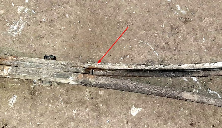

    Actually it was the second leaf broken, not the main one, so the axle was held firmly in place. Apparently it must be broken or cracked for some time before I noticed, judging from the look of the break line.
    It was just under the u-bolt so it was really hard to notice it without looking for the crack. Only when it started to squeak, it got my attention.

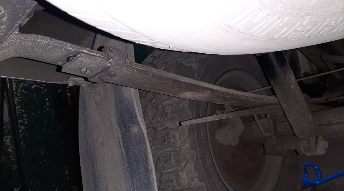

    Having an opportunity to get under the truck in the oil pit I checked the other spring, and this one does not have even a crack. It is a keeper.
    After taking the leaf apart he made a new spring that matched exactly the shape of the broken one. There was a danger that the maybe the other side will need also a new leaf, if the truck sits uneven under the load. However after new spring was assembled and installed the height difference was less than 1/2 inch, that is less than a weight of few gallons of fuel. So we call it a day - the whole process from drive in to drive out (including paperwork) took less than 2 hours, and cost me 74 dollars.
