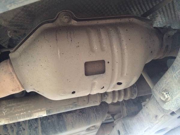

Please check for this heat shield clamp

    If it's not there then it could very well be your problem...

    I had a heat shield problem and all the dealership had to do was bend it back into place

    I had that clamp for a while. The clamp on mine broke and the shield and clamp was rattling away, made a terrible noise. I ended up taking off what was left of the clamp and the shield. No more noise.

    Had the exact same problem and solved it the same way :)

    Yes it does help. Looks like I'm ordering the clamp.... online of course.

    Lol, same happened to my sister's old CRV. We just put big ole hose clamps around it

    Sure enough, I installed the clamp this morning and no more rattle, so far.
