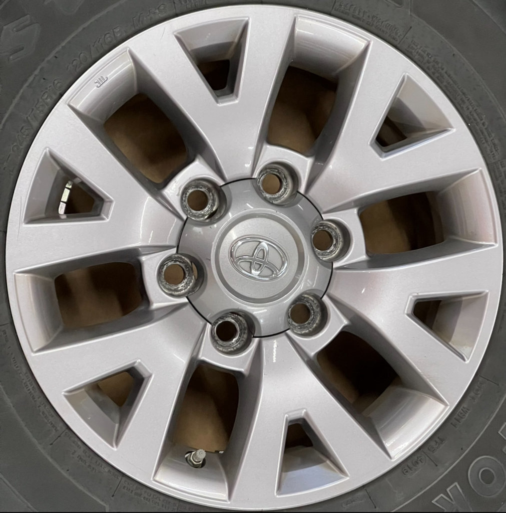

    I have a 2013 Tacoma. I just bought aluminum wheels from a 3rd gen.
    Lug Nut:
    90942-A1011
    TPMS Sensor: 42607-33021 PMV-107J
    I noticed there are long and short lug nuts. Which one do I need?
    Thanks

    Either length lug nut will fit oem length studs. I have lugs from my daughter’s 24 Corolla on my 07 Taco. My Taco originally had the long ones but after 16 years, they were quite worn out and beat up. She wanted black lugs to match her black rims, so I tried them on the Taco and they fit perfect.

    Thanks. Which length comes with the 2016s from the factory?

    Googling pics, it appears they have shorter ones. It is possible the 4x4’s have long ones, and Prerunners have the shorter ones.
