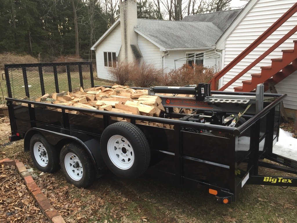

    I have a Big Tex 14' tandem. For the most part, I like it. Big Tex isn't all that impressive with their finishes though. This is my second one, and they both came to me new with surface rust... I got a good price on both though, and like the high metal sides. Those were the determining factors. Those, and inventory.
    I also had a problem with the wiring for the trailer brakes. The way they had the lines ran, they rubbed on the axle ubolt. Easy fix, but annoying on a new trailer.

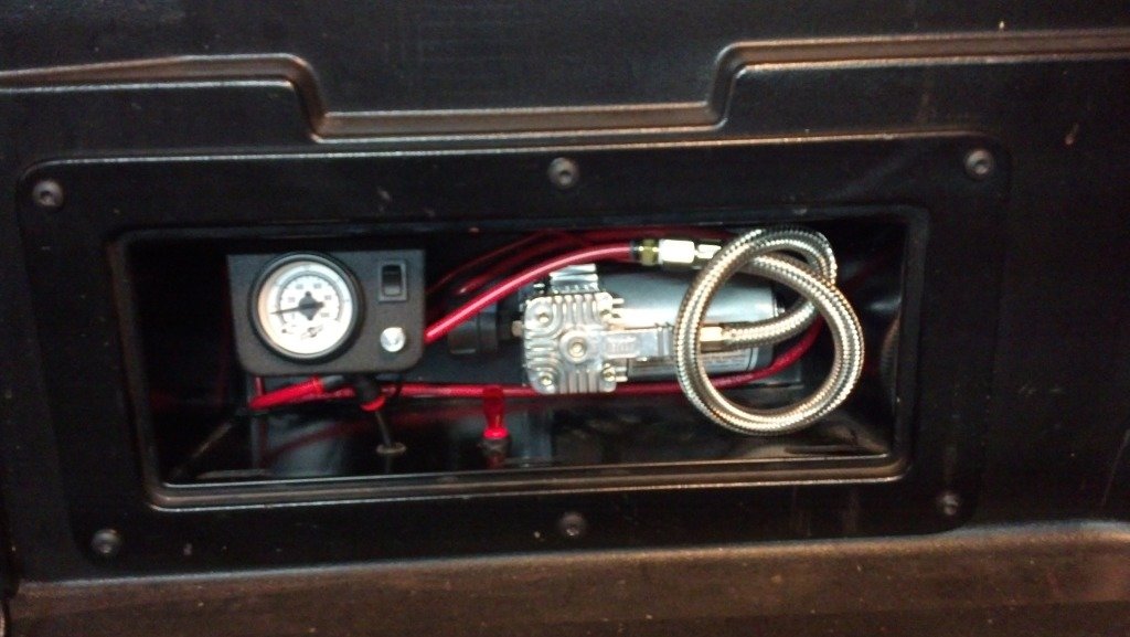

    I can't help with the WD hitch, but I love my P3.
    As far as monitoring trans temps, I also love my ScanGauge. So simple to install. I've never used an UltraGauge, but I'm sure they're great as well.
    I also have The Firestone bags with OBA. Best mod I've done. This allows me to use my truck, like its a truck...

    Thanks HHG, question....
    How much trouble would it be to set up the OBA so I could inflate both airbags to the same pressure, and then close a valve so I don't have air moving from one bag to the other around corners?
    I am kinda itching to put the pressure gauge, power switch and valve body in the cab so I can both monitor all the time and increase pressure even when I have a bed full of sawdust or top soil.
    There is clearly only one output on the compressor pump..so somewhere there is a T fitting and a path for air to move between the bags when lateral loads are unequal.
    Imma gonna go look under my hood. I wouldn't mind knowing dimensions on the panel with the gauge and switch if you have some free time. Looks kinda tapered, just top to bottom height and widest width across the top will answer all my questions if you have a couple minutes sometime.
    I am confident if I pull out the coin box and mount it there I'll start blowing fuses the next day.

    Hey PD,
    3 3/4 W X 2 5/8 H
    Remember, you need room for airlines in the back as well. They sell a compressor kit (dual path) that has a seperate line and gauge for each bag.
    I personally don't have any need for Seperate lines. If I haul anything big or heavy, it goes in my trailer anyway. That, as we all know, is perfectly centered on the ball. :D
    A couple of times, I have had to plan ahead and air up prior to loading due to access to the panel though. I'm thinking of doing a true OBA setup in the future. When I do that, everything will be in the cab.
    Good luck with it. If I can help, just ask.

    I really do like the idea of putting a OBA compressor in the cubby in the bed, but I am the guy that will forget to air up before the big scoop of top soil goes in, time after time after time.
    I am going to keep my air bags separated. The majority consensus here is it is OK to have one fill port for both bags, but I don't like it. I am not saying I am going to need to do it because I am special, I am not that talented a driver.
    What have noticed with an empty bed now that I got some dry pavement to play on is the factory leafs are softer than I would like. I have been playing with tire pressure some to try to dial in the effective spring rate, but it isn't the same. While searching and searching and searching I came across one owner who runs 8-10psi in both bags, separate and in that post he was talking about spring rates the way I feel and understand them, so I am going on with that. A truck is a truck is a truck, but I doesn't have to fishtail on damp pavement.
    For now I am looking at a good way to put two Schrader valves on the rear bumper, a dual needle gauge in the cab, compressor in the cubby, and some kinda connector on the rear bumper to attach a fill hose to - and a power switch to turn on the compressor somewheres inside the cab.
