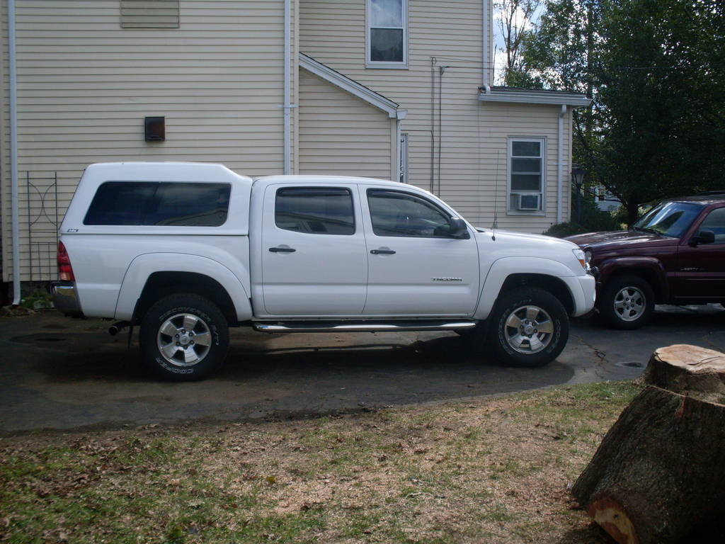

    5100s all around, 0 setting on the front, Eibach coils for 1.6" of lift in the front and the Icon 3-leaf AAL for 1.5" lift in the rear (2" if you retain the factory overload leaf like I did). Here's a pic of that set-up with 265/70R17 tires.

    sick picture man. i think the truck looks great as it is.
