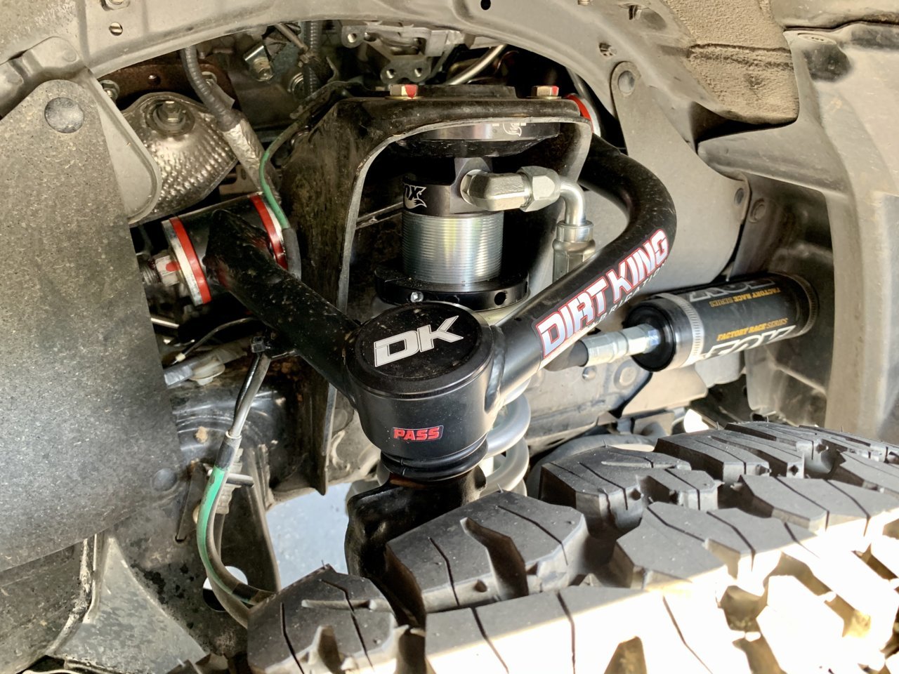

    The spring that comes with the Fox 2.5 extended tvl coilover for a Tacoma is actually 13”. If that spring is 16”, then You need to contact them and get the 13” spring.

    He was saying maxed out "to soft" lol. Was too stiff even without any preload.

    You got tundra coilovers! Believe my fox 2.5s are 16” on the tundra

    Just did and they said they will send me out new springs. I hope these 16in spring did not damage anything!?

    Yeah stiff like a straight front as soft as you can set it! Haha

    It may not be the exact same situation, but I had a 2.5 reservoir installed front / 2.0 back in October of 2019 by ORW. After install, I feel my "quality of ride" did not improve over stock. Even though I was told my set up (similar to yours, Dirt King UCA's to boot) my ride is fucking stiff when it comes to bumps.
    I don't feel like im being bucked out of my seat like you, but man I feel disappointed or I would have spent less money to achieve at least lift/look. I may take it to a Fox Service center near me in the future and have them inspect it and let me know if I am just bitching.

    I think the OPs problem was they installed the wrong spring. He had a 16” spring when he should have had a 13” spring. 13” is what comes with the Fox 2.5 ext tvl coilover for the Tacoma, 0”-3” lift. I think the same size spring should also be on your coilovers.
    Check your overall shock height. It should not be more than 21” measures from bottom eye bolt to the top of the top hat. This is measured with the full weight on the coilovers

    I’m getting a 14in spring because of my feature plans

    Yeah I have tundra coils on my shocks.

    Fox ended up sending me new springs 14in spring and it’s way better then what it was and yeah with the 14s it’s stiff but the extras In was to compensate for my metal bumper

    very common problem, but most won’t admit it. you’ve set your preload against a desired inch lift value, that’s not what preload is for. (Unless you are after looks). Preload is to set static ride height, the more preload you add to the spring passed “desirable”, the shittier the ride but the more lift you’ll get. Take 0.5~1” out of those preload adjuster then see what you think the ride, then dial in more/less from that point as you feel necessary for your driving.
