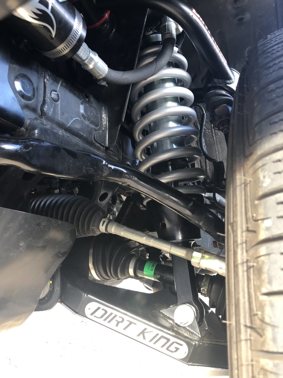

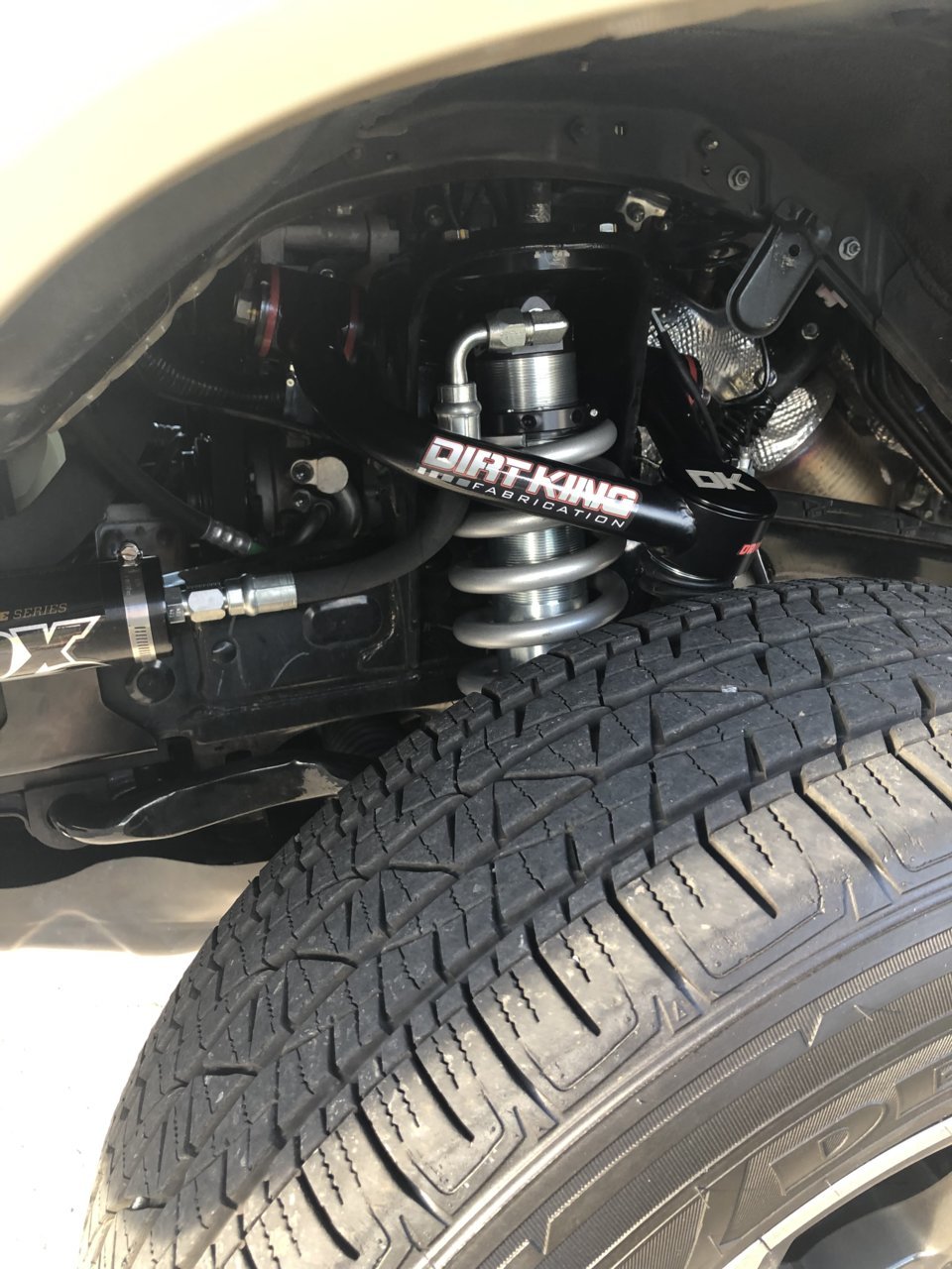

    D533FBC4-76C6-4131-9FE7-3F869229D516.jpg 6502D705-01E9-46A5-B5A8-A8BB4F627D0A.jpg I would think that I’m getting the bouncy ride from my (stock tires) I mean yes my UCAs look a little drooped from how it should be

    If you are satisfied with the Ball Joint angle, and the outer tie rod angle, your mint. That ball joint is bent like a dog's hind leg. Just sayin. (if it's sitting on the ground).
