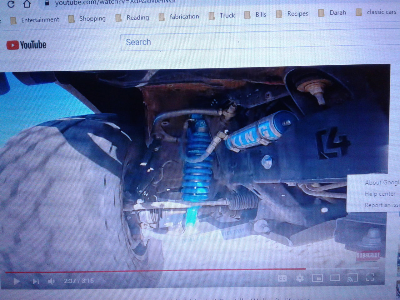

    I wish I could help you. I'd talk to the folks that designed or sold the combo. Here's the deal. In a normal auto or truck the lower control arm are almost level, the axle is level, the steering geometry is level. Now we introduce the desire to climb rocks, forge streams and jump dunes at 130mph...lol. This creates a problem with a truck designed to pick up milk and bread, and a 4x8 sheet of plywood for Harry the Home Owner....lmao. Make a phone call. You might find out some good info but just don't talk to "Jake". He's probably got no clothes on...

    I wanted to follow up on this. Sometimes I get a little too "cute" in responding. I caught this in a video and wanted you to see almost perfect geometry at speed. Even at rest, this is close to perfect. Notice how the upper, lower, axle, tie rod are all on the same plane. Speed is probably 50mph and has just come down from extension. The ball joint is almost 90' to the spindle. Mint. This is how it should look.

    t2ch

    And the point is?
    That's a long travel suspension and the shocks are more than likely custom tuned, not the OEM replacement coil overs the OP is using. apples and oranges but thanks for the pic.

    I don't do points. I do geometry. If your ball joint at rest is at 45' like the OP's, you've got a phucking problem. I'm out.

    I’d like to see his set up at rest :rain:
