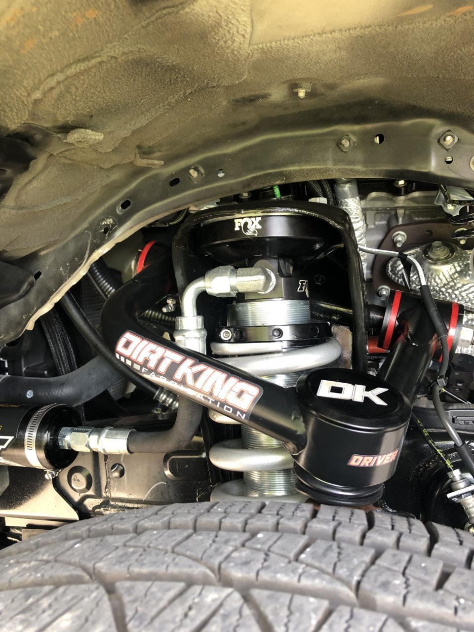

    Okay guys now I have my sway bar rubbing on my wheel hitting the balancing lead when I turn full locked 549A79F3-4227-4C7A-84AF-9C85057023A1.jpg

    Do you have the sway bar relocation bracket installed?

    Yes
    I should just take the dam thing off. But I drive a little fast on or winding roads. Here in are island to get to are off road and hunting and fishing areas. 45-50 on a 25mph road

    I believe in your earlier photos you were still using the stock TRD sport wheels? If so these are 17x7.5 with +30 offset. This means it has a 5.5 inch backspace. Your Dirt King LCAs according to the manufacturer's website say max 4.75" backspace. You need new wheels or wheel spacers.

    Thanks man!

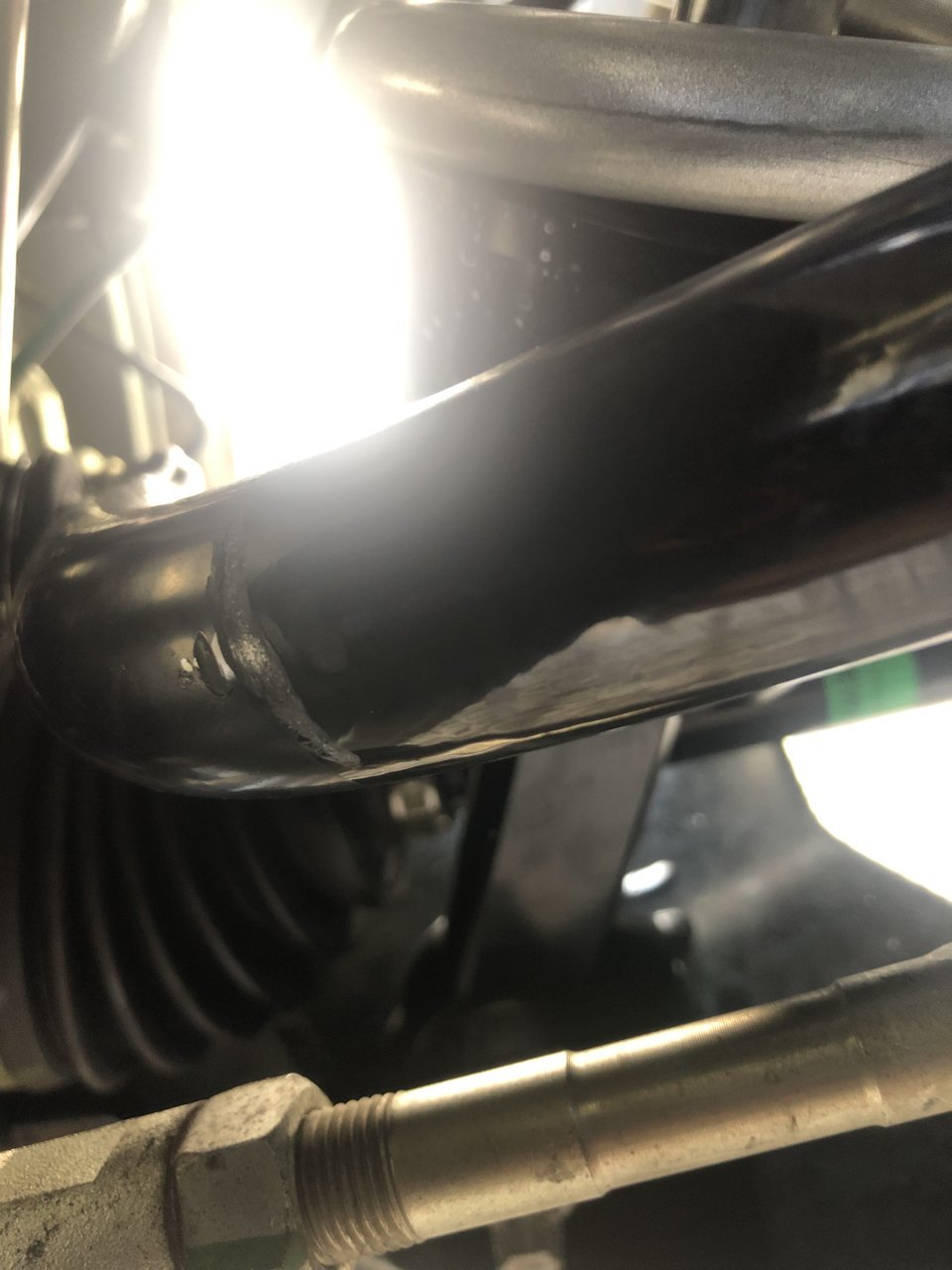

    So finally got it turned down to what fox has recommended to start with threads showing about 3/4 in and my lower eye to the top hat is 21 and quarter of an inch. The ride is a bit still bouncy and wondering if I should crank it down more or should I just leave it till front bumper gets here and should be fine?

    48782781-B848-43E2-B92F-80A3419D51DA.jpg Okay guys so I turned the ring to have about 3/4 on an inch left. That is what fox recommend for my 3in of lift. Remember I have a 14in coil not the 13in that comes with the fox 2.5. Adjusting it did make the ride softer but it’s still really bouncy to me. This will go away right when I put on my tires and wheels. I’m going to be running 285/75-16. And also adding the weight of a number and winch will help as well? Or should I just crank it to make it softer? Lmk please

    The extra weight should make it ride better. It might also lower the total length of the shock. It would be cool if the weight brought down the overall length to 21”. Then you will be golden!!
    I’m glad it’s working better for you.

    Oh dang I did not see that but I just checked and I think that’s was a great smuge cause I just looked and did not feel or see anything
