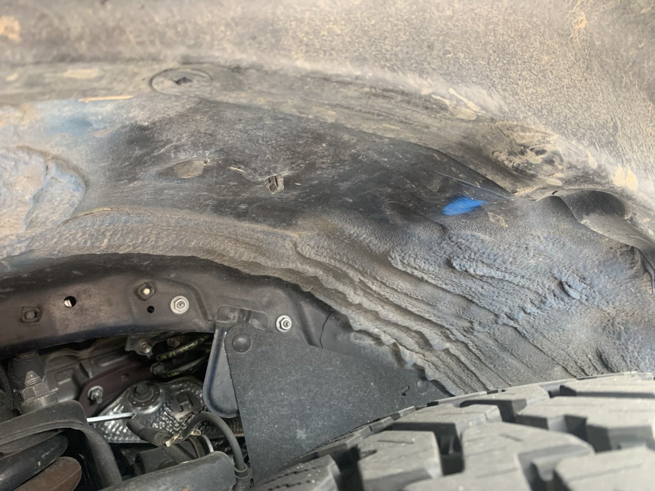

    So I have a 2021 TRD off-road and I just replaced my stock 276/70r16 tires to the next size up. I was under the impression I wouldn't have any fitment issues but I was wrong. I'm experiencing rubbing on the upper wheel arches. Just curios if anyone knows why.
    Truck is stock height..no spacers.
    New tires: Falken Wildpeak 265/75r16

    Pictures of the upper wheel wells would help immensly.

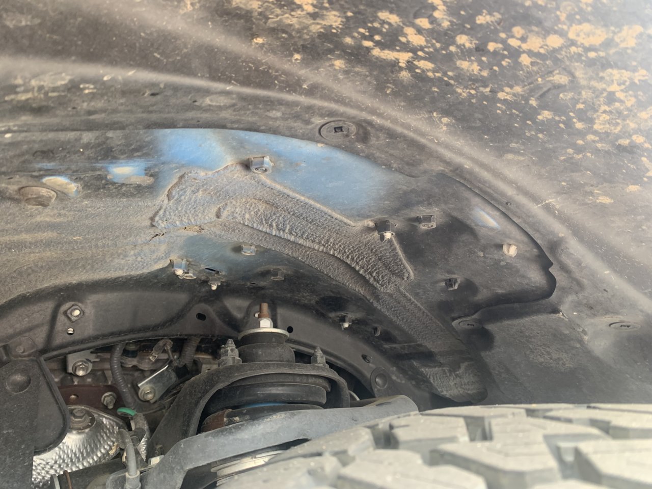

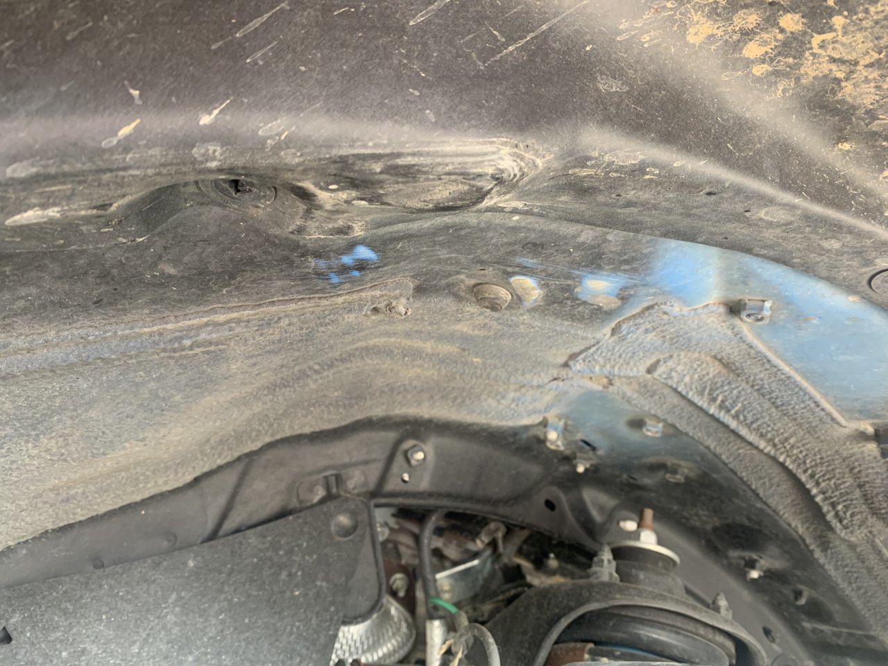

    It's not much but this was just in a bumpy dirt parking lot
