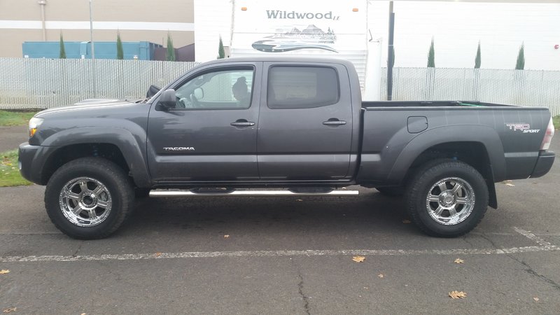

    Just bought first tacoma,09 sport,been getting bad mpg,is it because it has leveling kit with 285/65/r18's on it,and if so what is a good on/off road tire.

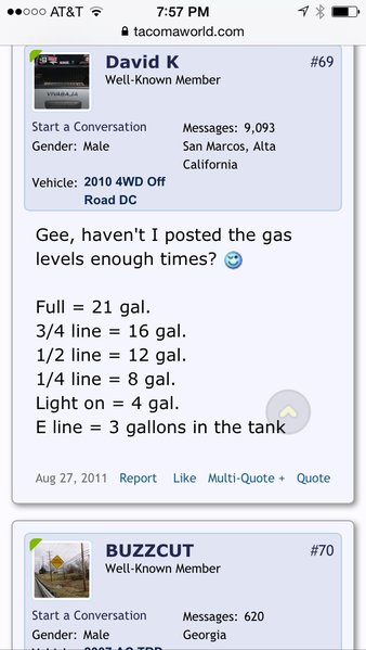

    Def need some numbers. 10mpg seems really low even for your setup. Air your tires up and use the chalk method to get the proper inflation. FYI 1/4 tank still has around 8 gals remaining in the tank.

    Leveling kits change the aerodynamics of the vehicle. OR and under-inflated tires add extra drag as well. The pic is a little dark, but your tires look like BFG Rugged Trails. Those are decent on gas mileage (I just replaced mine), but they are larger than stock so that changes things, too. IMO, with that setup, you should be happy getting around 17 mpg avg.

    Thank you for the feedback so far here is some of the answers to the questions I'm at 160 miles and I'm in between a quarter tank and a half tank exactly, the tires are BF Goodrich all-terrain triple ply,and the tires stick out one and a half inches from the side of the truck and here is a new picture..20151027_090827.jpg

    You still have half a tank left in the tank regardless of your gauge. Drive her down to your comfort level. Fill it up and do the math of miles driven to gallons pumped in. I bet you are gonna see better mpg than you think your getting right now for your 21 gallon tank.

    From another thread which i have found to be spot on.....
