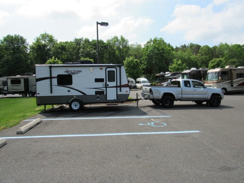

    2017 kz sportsman classic toy hauler
    Box measures 16.5 long not sure why its called 19fkth
    Here is my truck with it but not hitched
    I wonder if dealer will let me hitch it

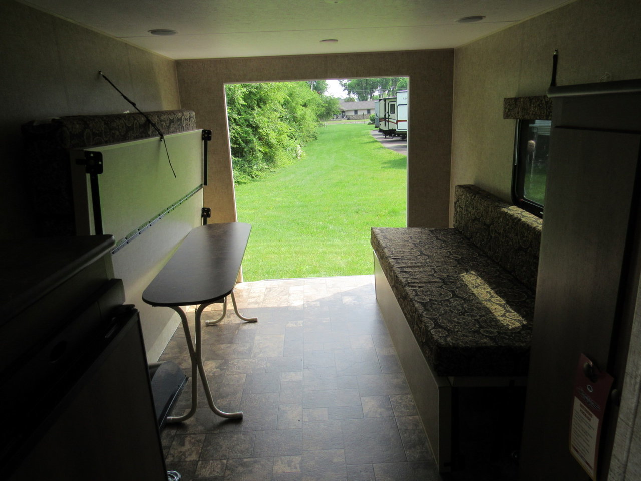

    Like the open floor plan. Both beds folded down will make a king
