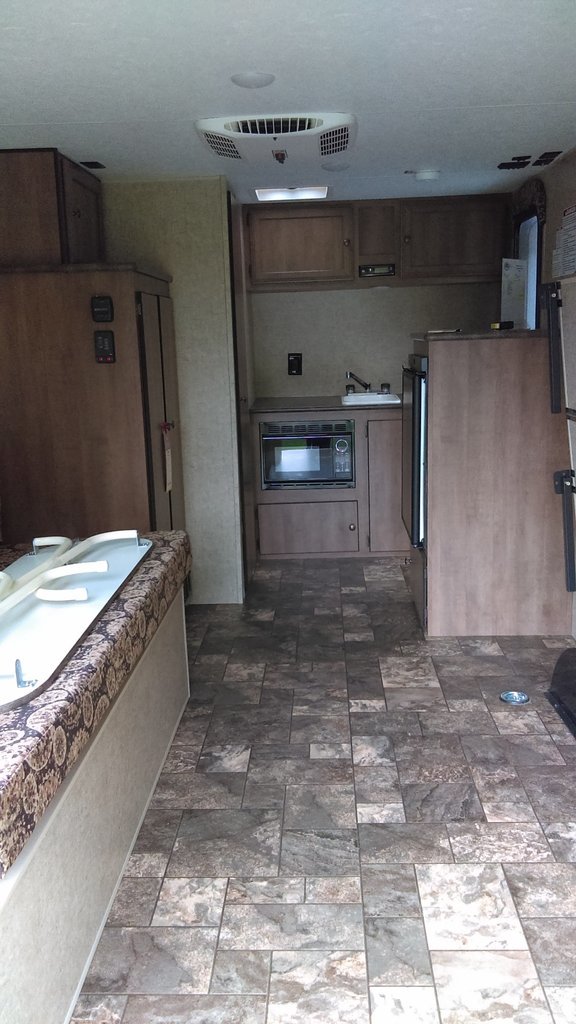

    another pic

    Yeah those small toy haulers always have everything important in the front and bedding in the back. It's the only way to do it.

    The wife and I love it,only thing I dont like is the shower area has waterproof paneling with waterproof wall paper. I would have to install the plastic type shower pannels on the 2 walls. Not a huge deal,I also didnt want the big 13,500 btu a/c on the roof. I really wanted the 8,000 btu in the wall. Rooftops are a pain to work on. And it probably wont fit inside my already tall carport with that a/c unit on the roof. I can order one with wall unit but it will take 2 months or more to have built.
    Dealer says he will install Fastway hitch rated for 800 tongue and 8,000 max for $300 seems good deal for the hitch
    Im thinking firestone airbags in future will be nice
    Now I just gotta make up my mind...I know she will tow it,but will it kill my baby lol? My 2005 only has 62,000 miles on it:fingerscrossed:
