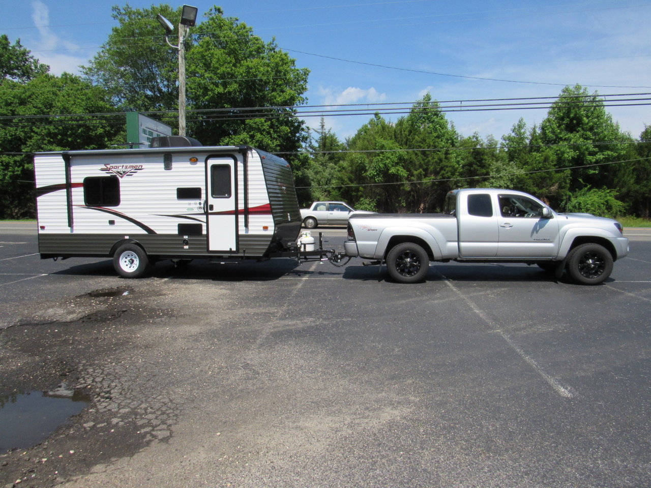

    blazze2005
    blazze2005 [OP] Well-Known Member
    Jan 18, 2010
    #29594
    966
    South Jersey
    05 Tacoma Pre-Runner Sport
    Fuel Off-Road Octane Wheels,Yokohama Geolander ATS 265/65/17.Grillcraft,Borla Exhaust,Truxedo Lo Pro Tonneau Cover,Pop n Lock Tailgate Security,Custom Wet Okle TRD Seat Covers,Catch-All Matts,Gatorback Belt,Shorty Antenna,Toyota Bed Matt,Sirius Radio,Vent Sades,20% Lumar Window Tint
    Here she is empty with the fastway e2 WD hitch...She looks pretty level, I gotta measure looks to be about 4.5-5" from bump stops hitting. She towed really nice with no sway problems around 55 mph in 4th gear. The guy that set it up said camper is 1" inch higher in front then the back.
    If I were to get airbags,I would most likely have to go with the 8" drop reciever as the camper would sit higher in the front
    Xjman1 likes this.
