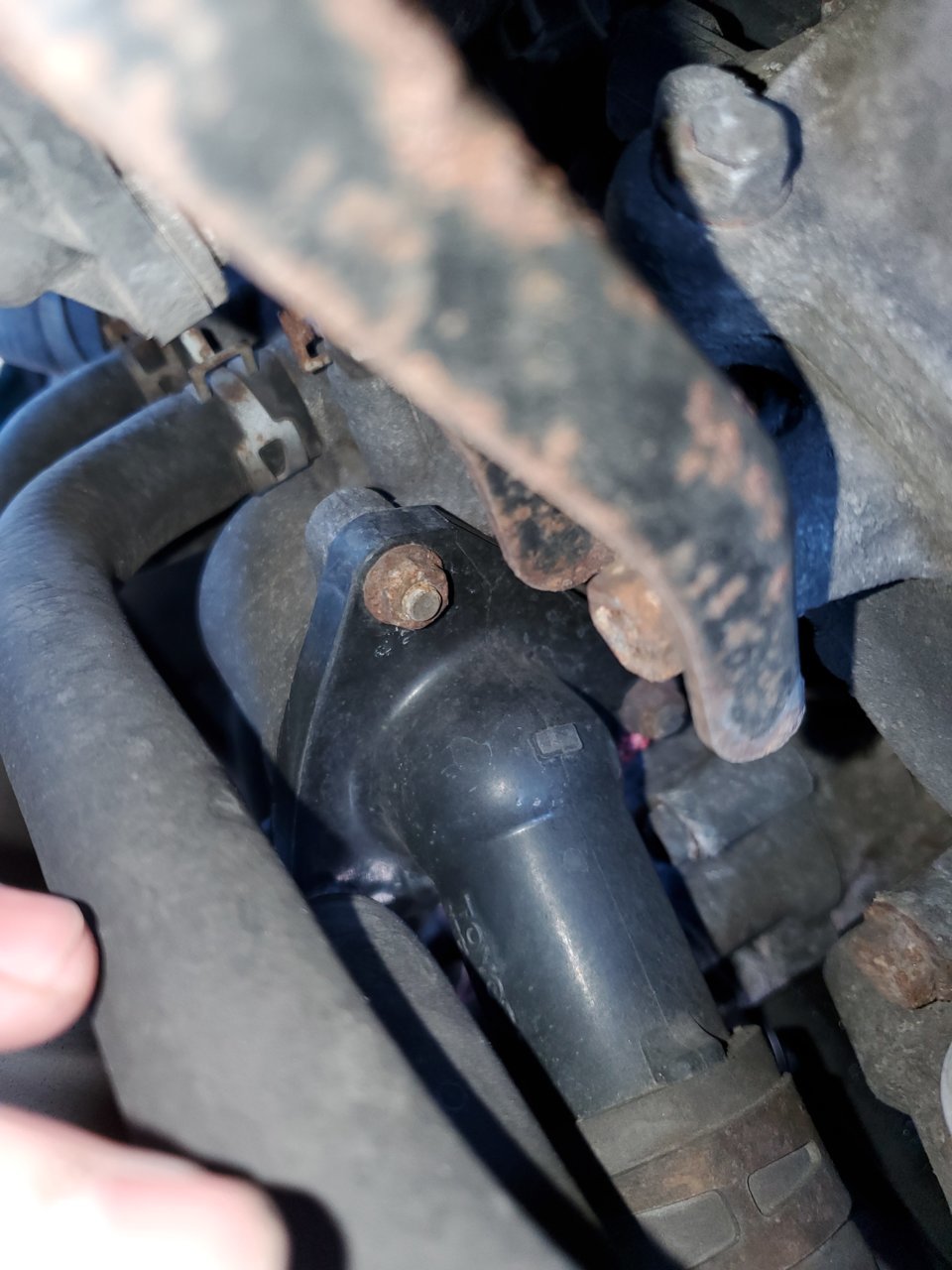

    Ok sorry about the horrible pic but here is where its leaking. Is this the thermostat housing? Black thing you can see where its wet on the left bottom

    This is what is leaking at the mating surface. There is a gasket in there right? And that is the thermostat housing?

    Correct on both counts....are you having any thermostat issues? or is it just a leak? might want to think about (consider) replacing the thermostat if you're having to replace the gasket...

    They have a kit at autozone for 40 dollars thermostat, cover, gasket and seals. I'll replace it all after work

    Judging from the pic I’d replace the nuts too. They look pretty crusty. Hope they come off for you. If it’s a slow leak maybe soak them good with some penetrant first and let them sit a day. No reason to make your life harder.

    Here is the thermostat inspection and install instructions from the FSM. Gives the torque specs.

    OEM Toyota part number for the nuts as well 94151-80600 times 3
