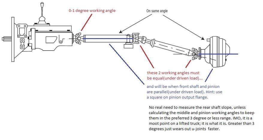

    Unshim the carrier bearing.
    This is what you want to do:
    jsinnard, Bastek and Chipi3s like this.

    Awesome! Perfect visual. Thanks

    Also, quick question.
    If you accelerate and the rear diff angles upward decreasing the angle at the rear pinion...won't this technically do the same to the joint right behind the carrier bearing. if rear wraps up, middle gets closer to straight?

    Yes; not near as much as the pinion angle though. It's not rigid; there's a slip joint.

    ahhh that is where the slip and spline comes in with that ribbed rubber boot?
