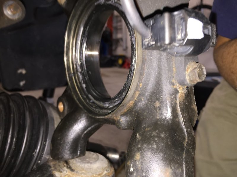

Please Help - How do I remove this seal?

    It's on engine side of driver side front knuckle.
    Thanks!

    She's torn anyway which is why I am replacing. So just grab it by the lip with vice grips and pry?

    Hammer and screwdriver from other side will make quick work. New one is kind of a pain, I used a wooden block and a hammer.

    I use a curved headed crowbar called a lady slipper, but almost any type of bar will pry it out.

    Okay. Will try prying it off first. Thanks for the tips!
