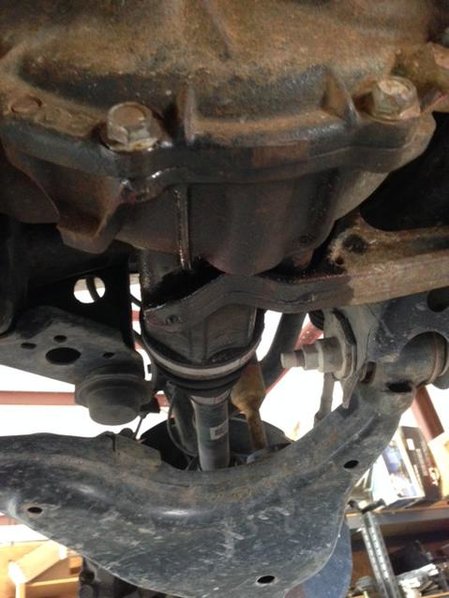

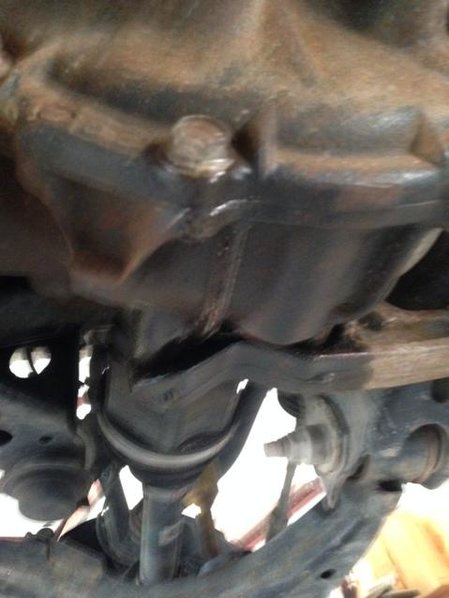

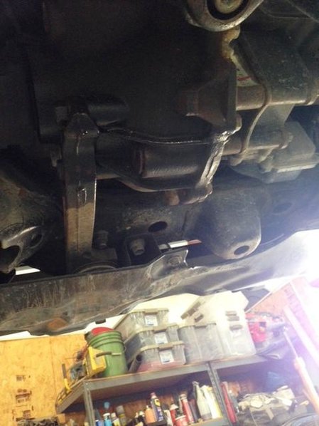

    Need help !!!! I took my 2007 sport Taco to get it lift 3"yesterday when he put it on a lift we saw oil on the front diff here are some pics of what it look like truck have 107k miles onit.... please tell me where you guys think it's coming from...:confused:
    Thank you,
    Codeman....

    agreed, that it is probably the front axle seal

    this 100% I have had the same thing prior to my ARB locker being installed

    If you putting a lift, get new seals on both sides at the same time. Until than you need to check and refill front diff oil level.
    Also I would make seal a priority over lift

    I would get it dealt with ASAP. At least keep the front diff topped up with fluid until you get the money to replace the seal. (Blue beat me to it).
