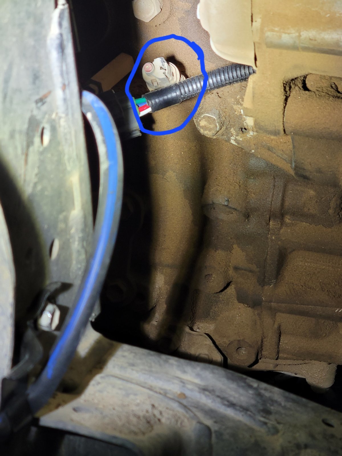

    Looks like the oil pressure switch.

    Looks like the wire to that sensor connector was cut. Press the right side of the connector and it will come off. Take to dealer to get a new one.

    That is easier said than done.
    Toyota seals the connector and the wire separately.
    Finding a parts guy that can/will look it up is the problem.

    As DM93 said, it appears to be the connector for the oil pressure sensor. The OP will then have to splice the new connector’s wiring to the harness.

    looks like it broke off right at the connector.
    It would be easier to depin the connector and pop in a new wire w/terminal.

    Wire Terminal parts # 82998-12590

    Thank you everyone. The neighbors dogs chased a squirrel and ripped out a bunch of wiring. Already had to replace the o2 sensor and o2 sensor pigtail, as well as the abs speed sensor. We keep finding things unfortunately.
