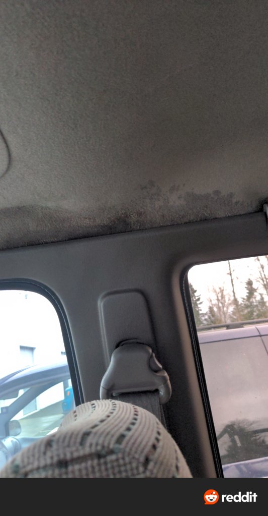

    I have a 1998 Toyota Tacoma limited and recently the sunroofs been leaking, the rubber around the outside is worn down and absorbed the rain and it's getting my passenger side roof a little wet. I can find the replacement seals anywhere, is it possible to just use some weatherstripping and stop the leak, any input is appreciated!

    I believe that Toyota uses a similar system for draining their sunroofs on many of their models. If so…I had a 92 Landcruiser that leaked because the drain tube was clogged. Solution was to snake a piece of wire down the drain hole which goes down the A pillar to an opening with a gasket. Amazon sells a wire tool. Here is a YouTube link https://youtu.be/MOQWehtoGyw?feature=shared

    Every time hard rain….wet musty smell
    Then after some hurricane, 1inch water on floor board
    searched
    Dropped headliner and cleaned SR rails(nasty baby food paste) and blew out/bleached drain lines
    No issues since the full day job

    @SaltyKK please post some more photos of the inside/outside of the sunroof.
    It’s important to know if this is a Toyota sunroof or a “dealer installed” one that was just cut a hole into the roof.

    Could have been added after it sold as well. Pics would help for sure, photo the switches too, those could be a deciding factor on it being factory or added later.
