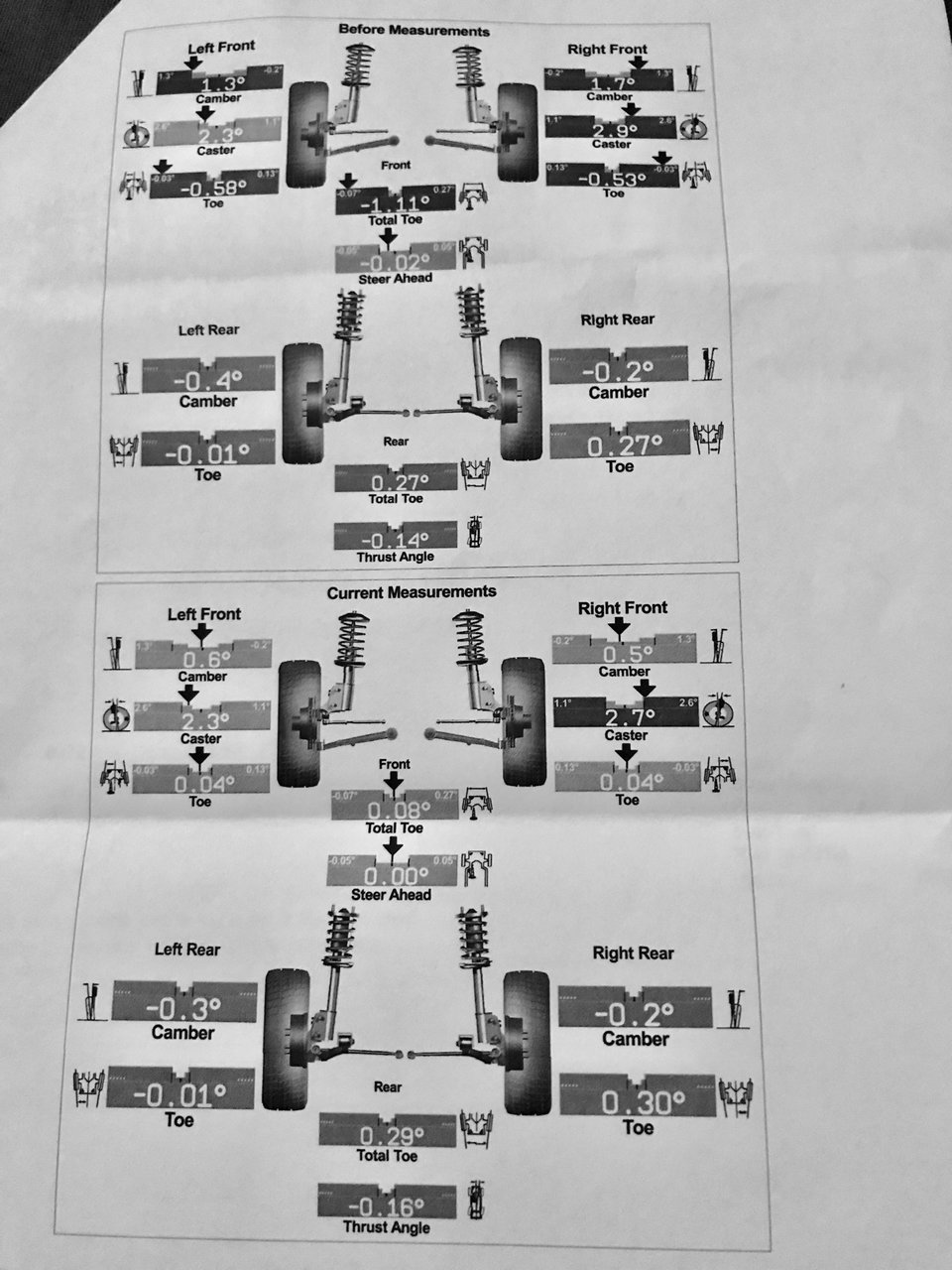

  4. Dec 18, 2017 at 1:05 PM
    #24
    stevotivo12
    stevotivo12 Well-Known Member
    Feb 3, 2016
    #176967
    1,638
    Stephen
    2016 Silver Tacoma TRD Sport MT
    Front hellwig sway bar,All pro sway bar end links, Fox 2.5 Resi Coilovers and Shocks, Fox 2.5 Hydraulic Bumpstops, Budbuilt Traction bar, Total Chaos UCAs w/ heim joints, Icon AAL, AFE Power Intake with dynamic scoop, URD spec U, URD short shifter, Flossy weighted shift knob, michelin tires, black badges, black tailgate letters, black grill with custom Diaz Fab Devil horn yota logo, retrofit/morimoto HID conversion, red interior LED lights, Pioneer head unit, kenwood excelon door speakers, 2 10" pioneer subs,
    That's pretty good. With aftermarket UCAs and a lifetime alignment paid for you could get as much as 3.0 degrees caster with a healthy amount of negative camber. I would keep going back to Firestone until you love the way the truck drives since you paid for that. I'm running -1.0 degrees and so far have been really happy with the turn in and additional cornering grip over stock alignment but I like to float through corners.
