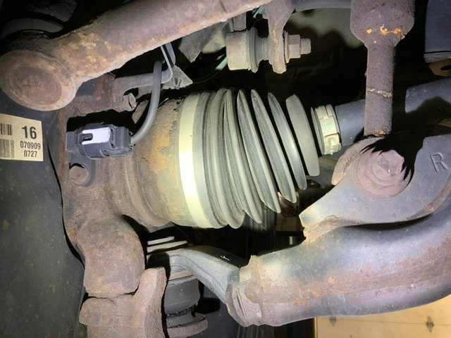

    UPDATE.
    They’re recommending new axle shafts and a rebuild on the drive shaft including u joints. $2668
    Tech believes the noise is from axle shafts and slight vibration is from u joints.
    thoughts?

    I don't think it's CV shafts, they typically make a clicking sound when they go. I'd bet ujoints will fix the noise and vibration.

    Front axle shafts are vibrating very badly
    That’s the tech notes for the cv shafts. Seemed odd to me.

    Id remove and replace the U joints, and THEN see whats up...that squeak is NOT the CV Joints..unless theyre leaking and slinging grease everywhere, and completely dry now, but my truck was making that exact squeak, and it was the U joints.

    Also said they sub let the service because they can’t balance the driveshaft after doing u joints.

    I would find a different shop! You should not have to rebalance the shaft when just replacing U-Joints.
