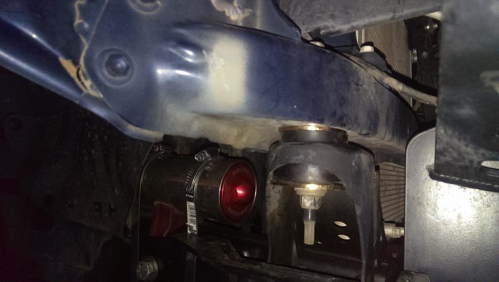

    Should look something like this:

    Somebody else's pic:

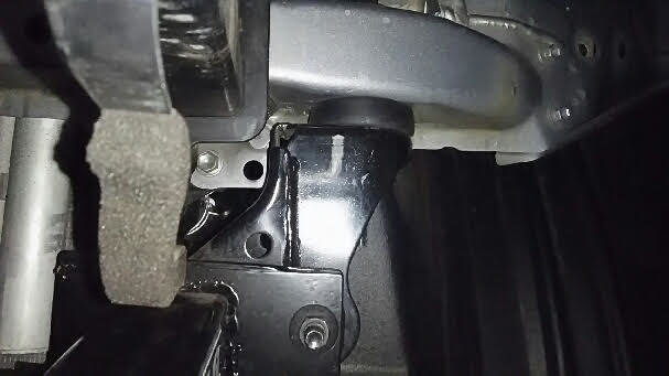

    Clearwater Bill
    Clearwater Bill Never answer an anonymous letter
    Oct 11, 2014
    #140097
    24,524
    Billy
    Largo Florida
    '13 5 lug AC w/convenience package
    A few OE parts from fancy trucks

    Yes i have followed the frame forward and found the two foremost bolts by the radiator. They are by no means accessible without removing other parts. Ive been on both of those threads that you guys got the pics from. Especially the one started by canyonrunner and he says there is nothing to remove to access them. I really appreciate your efforts but it has to be some other bolts he is talking about and uploading pictures of. So please, someone find these fuckin things and show me where they are

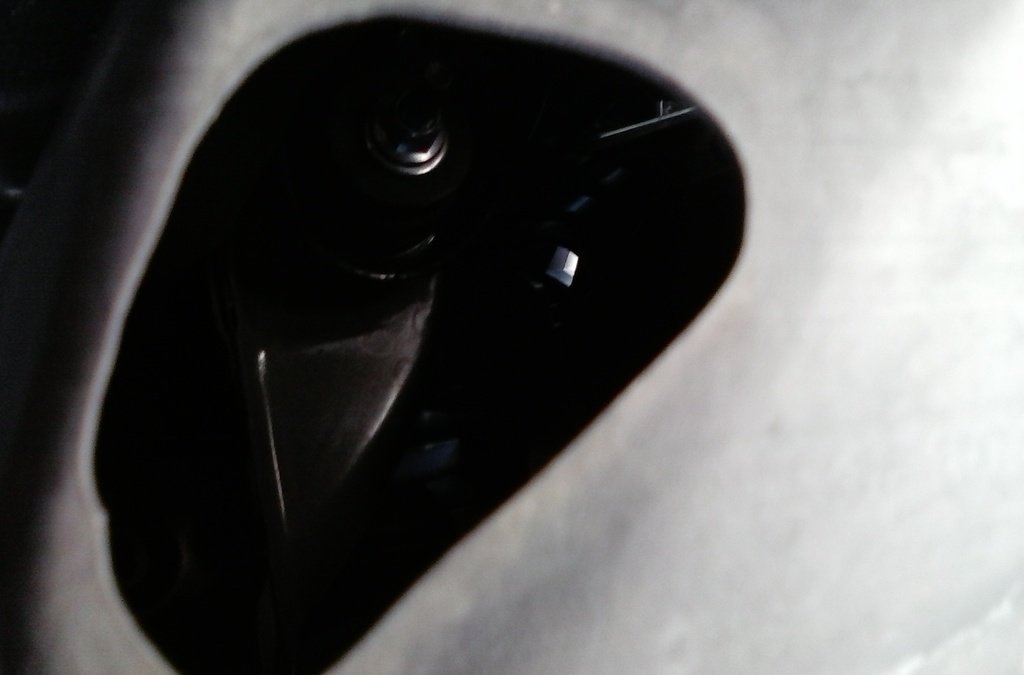

    Look straight up from the ends of the front/radiator crossmember.
    Looks like you'll need to remove the fender liners to access them.
    Driver's side; looking up through a hole in the bottom of the fender liner.

    These are the exact ones I found. And I realized they aren't accessible without removing the fender liner. Canyonrunner and everyone in that 2nd gen thread says nothing needs to be removed
