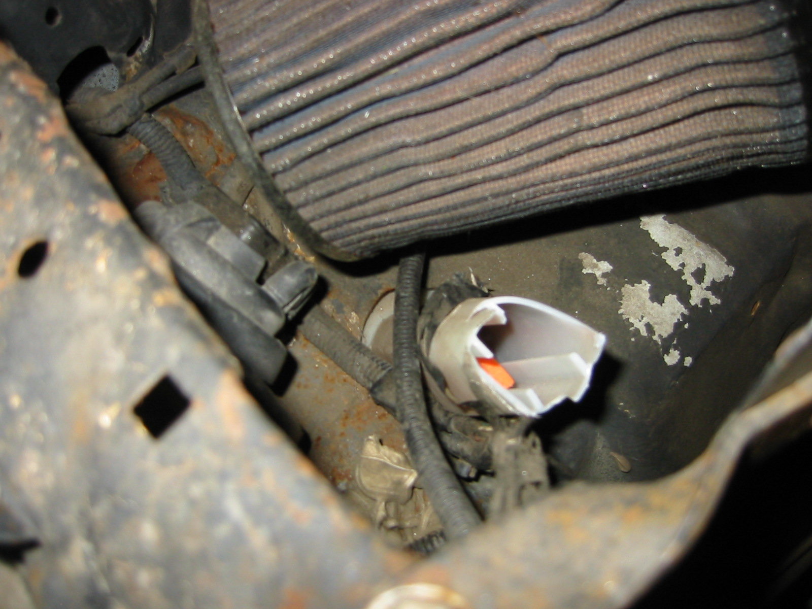

    The easiest way to tell is if you have the long filler neck sticking up off the tank.
    If not, It's not col weather spec.
    If you do, then you need to know if your truck has a fluid level sensor.
    8531504040 - Standard Non-Cold Spec. (No filler neck)
    8531504050 - Has NO sensor
    8531504060 - Does have the Sensor.

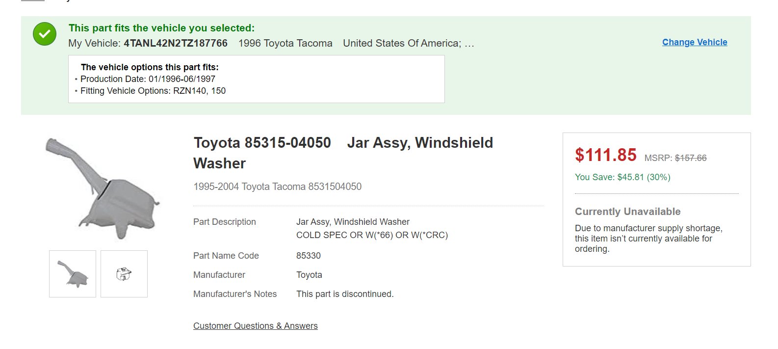

    I doubt it has a sensor yes it had a long neck not much of it is left LOL sticking out the top is this it https://www.toyotapartsdeal.com/oem...year=1996&submodel=&extra1=&extra2=&filter=()

    ChatGTP isn't that good. It's "good" but it's still dumb.
    Take a look at what that same site says....
    It says EVERY one of the part numbers I listed above fits your truck.
    Again, You'll need to pop your hood and look to see if you have a filler neck.
    It will be obvious........

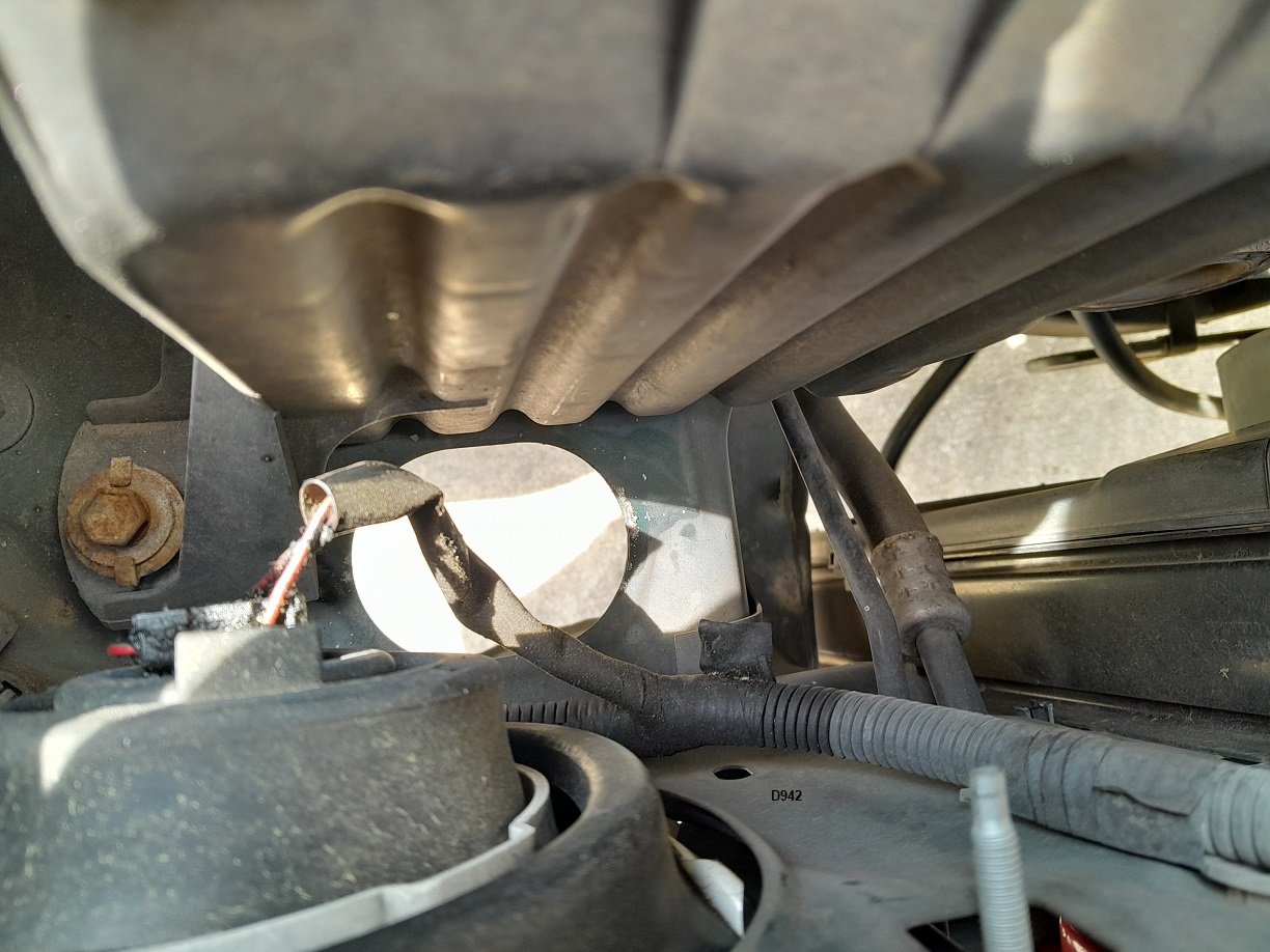

    upload_2024-5-30_22-9-8.jpg HERE A PIC OF WHAT IS LEFT
    Black97v6MT and TnShooter like this.

    Not much to go on, unfortunately.
    You might want to get a new air filter, though.

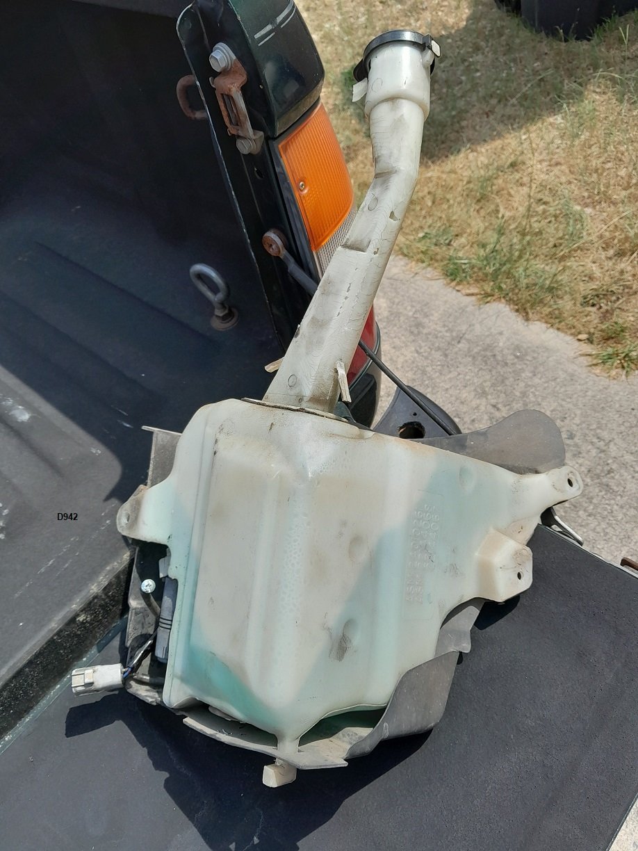

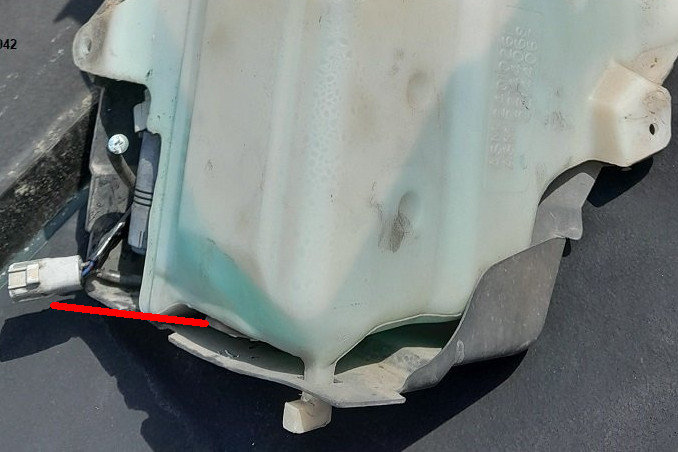

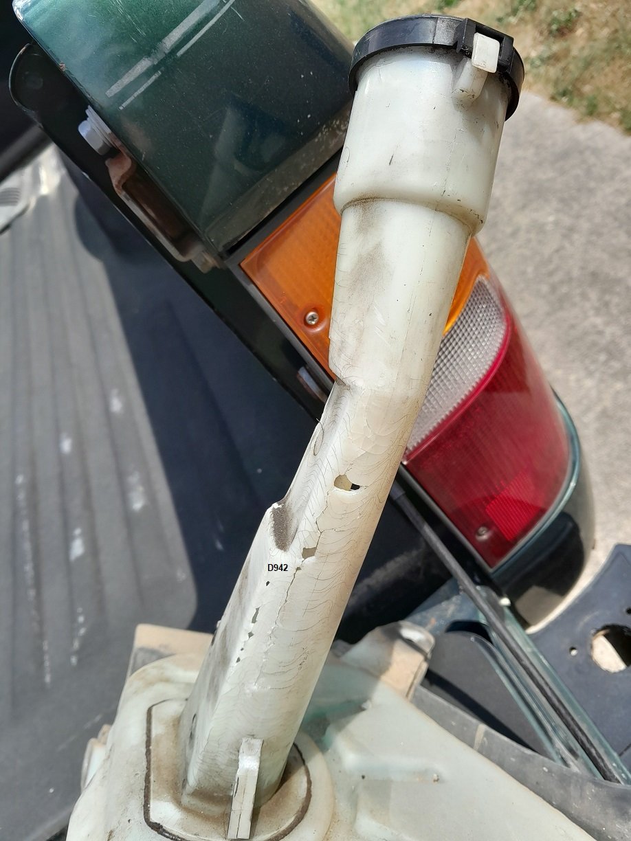

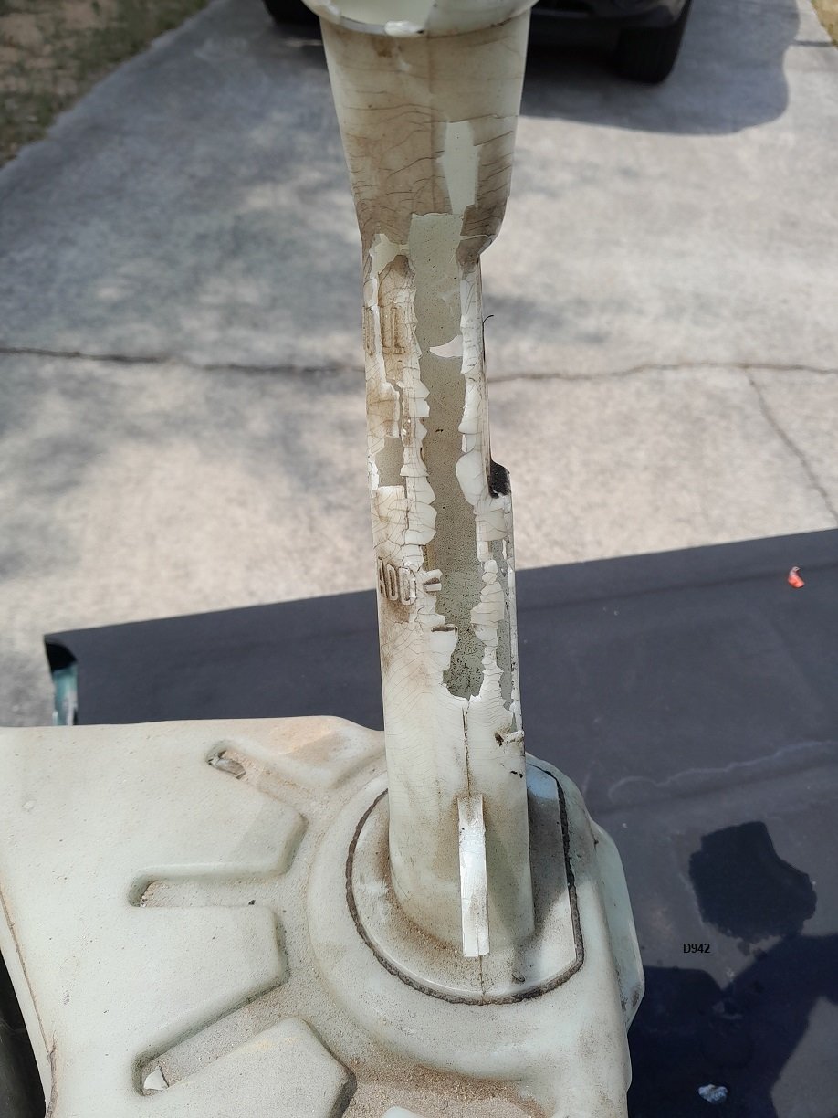

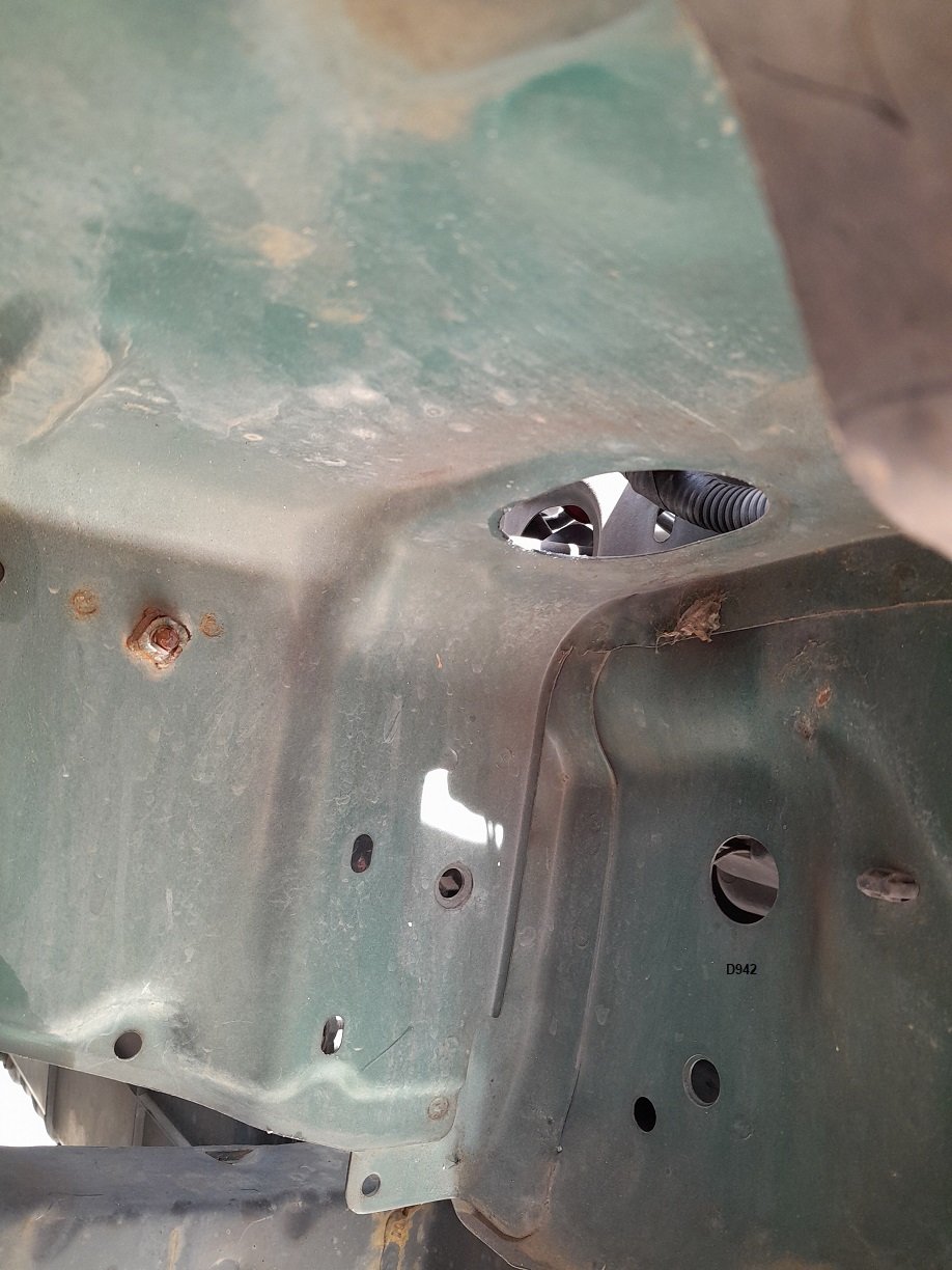

    I'd like to get in on this one too. Just removed my unit yesterday. Neck has been in bad shape for a long time, replacing doesn't seem practical based on cost, and I appreciate the exchanges above though not sure what I will do next.
    Wish I could just replace the neck.
    20240617_155215_30.jpg 20240617_155200_30.jpg 20240617_154916_30.jpg 20240617_154855_30.jpg 20240617_154842_30.jpg

    Haha Yup, the OEM reservoirs are off the hook. The irony is the aftermarket ones do separate at the neck but you still can't get them separately of course.
    I can't see the bottom of yours, but it doesn't look like it has the level sensor which is a bigger hole facing downward. Get one from Rock Auto. More info here.
    Edit: or maybe it does have the level sensor, is that the edge of the sensor grommet I see or is it just a plug? In that case you do want the "cold weather package" version.
