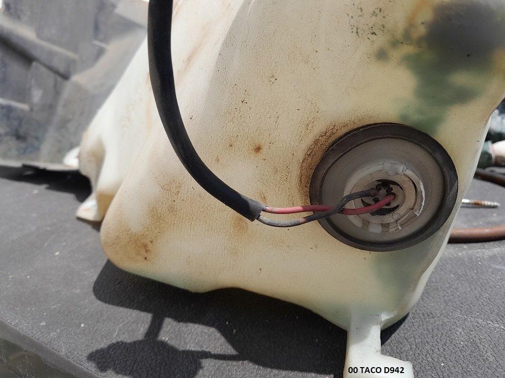

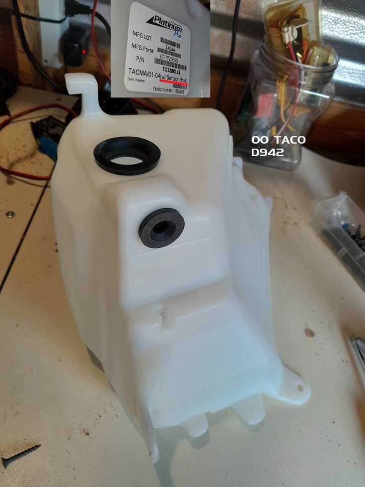

    Thanks #Rocknbil, I took a closer look after seeing your feedback "level sensor which is a bigger hole facing downward" and it turns out it does have the sensor. I had been flipping back and forth over replacements as many that did not have that plug had issues with leaking around new gasket. You made me confirm, thank you, part ordered and on its way.

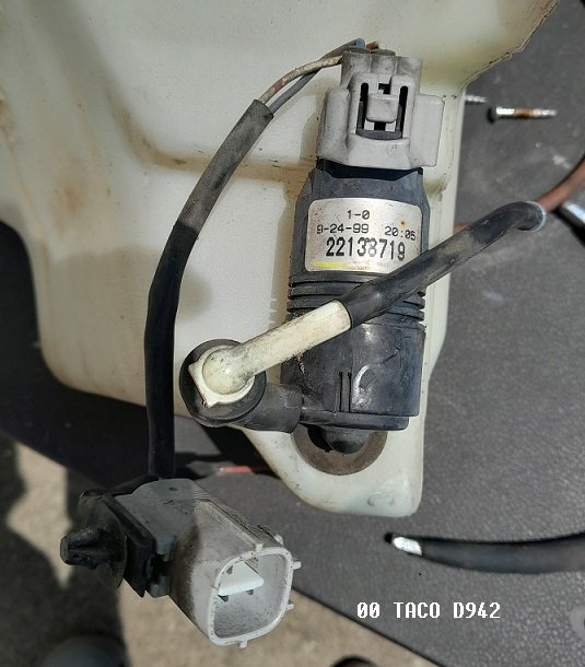

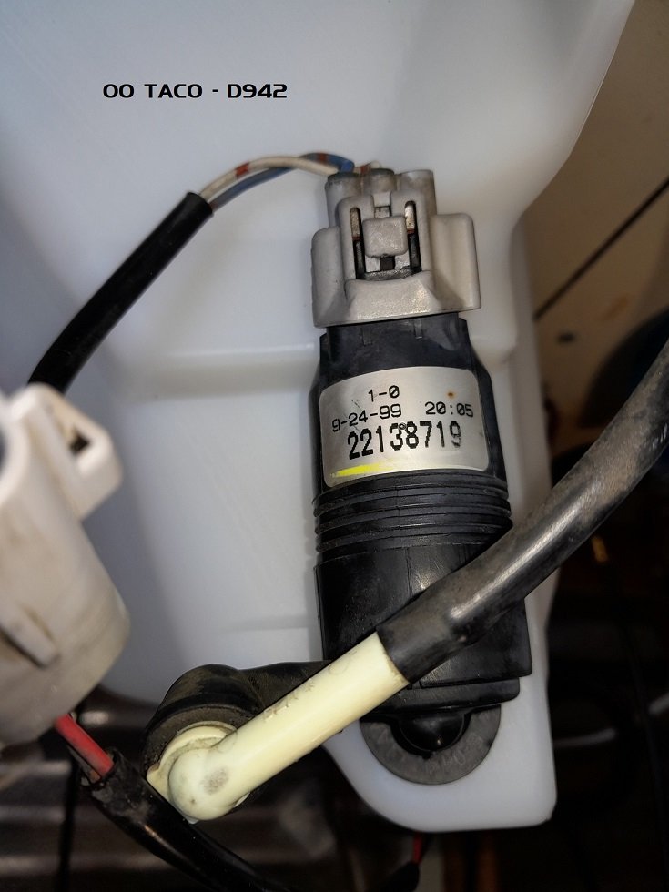

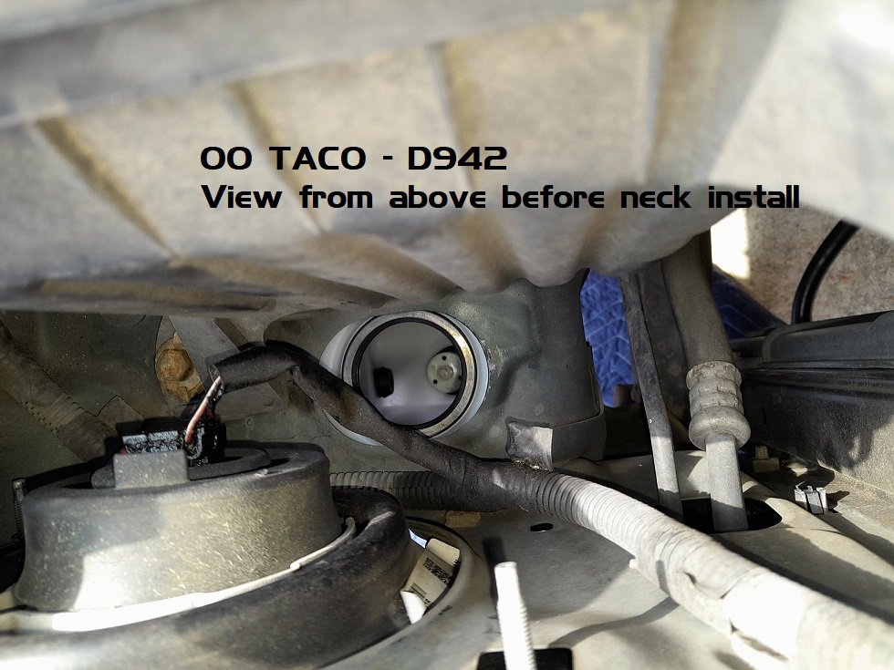

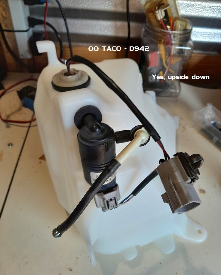

    Few additional photos that may help someone.
    Will provide more once new parts are in and installed.

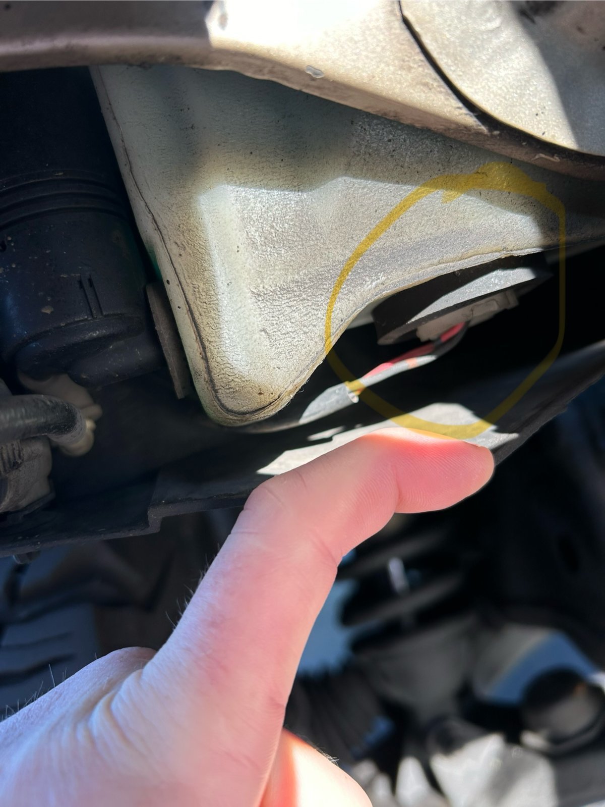

    OP, I just did this job. If you have a sensor here is what it will look like from under the passenger side bumper.
    If the circled yellow part is there then you need the reservoir with port for the sensor.

    The pump can be pulled/twisted out by hand. Use a long screwdriver to push the sensor, if equipped, out from the inside. Either order new seals or be careful removing the old ones - they can be re-used if not damaged.

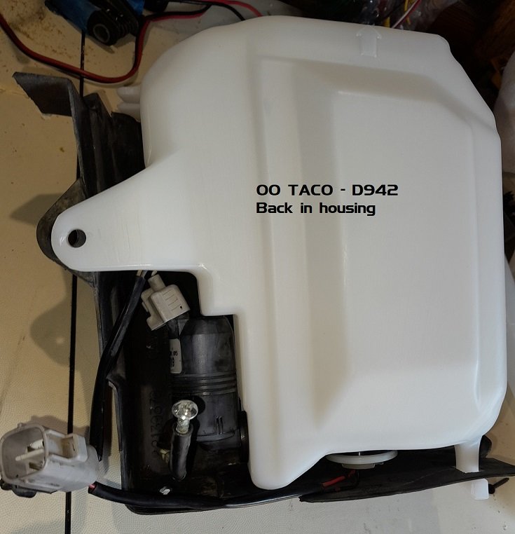

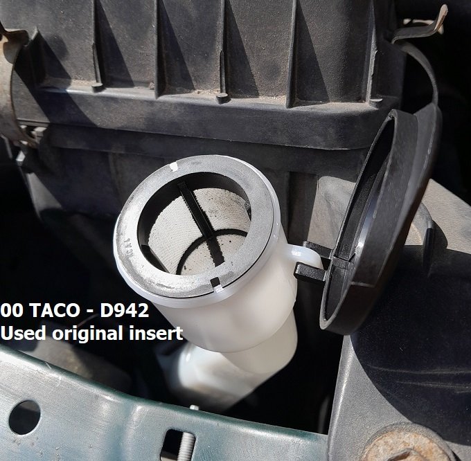

    Ok folks hoping this wraps up my input on this one, I know I share numerous photos but its how I work through it all and hope it helps others. Got my replacement unit in from Amazon (OE Replacement Washer Fluid Reservoir TOYOTA TACOMA PICKUP 2WD (Partslink TO1288183) $50)
    Reinstalling was a snap, turned wheel out for access, no jack required. 4 bolts, one connector, one fluid line then pressed filler unit in from above. Used the screen from my original part. Tested. Unit 100%. Thank you all for the input, support, and 'oldguy128' for this original post. Cheers.

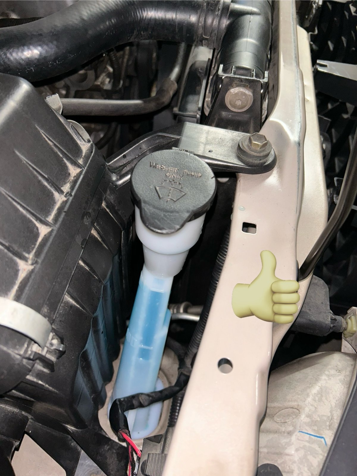

    Here's another image from a little farther back -- from my 2003 DC with ARB bullbar -- to help people orient themselves to what one needs to look for. Note the washer pump with the wiring and tubing at left-center, and the bottom of the low-fluid indicator at right-center, just beside the body-to-frame mountings.
