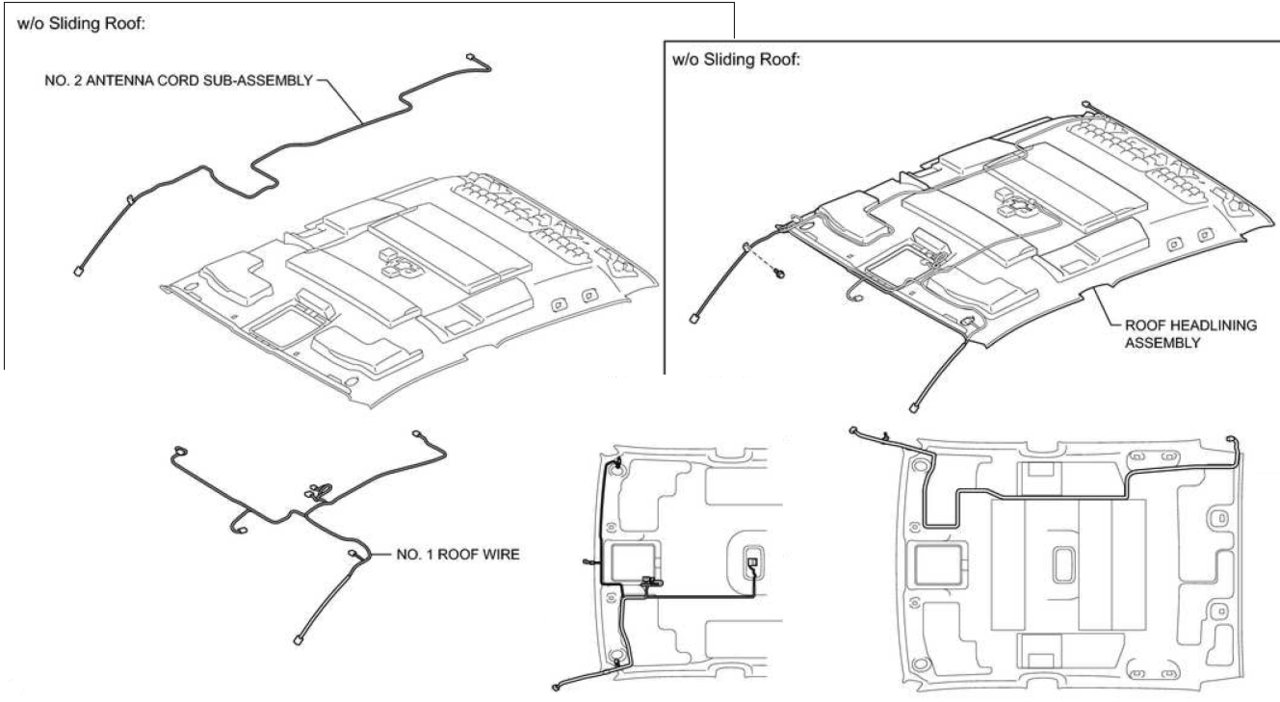

    For what it’s worth, the only Toyota-approved repair method, is butt connectors. If you want to buy a new harness, you need to buy a headliner.
    Toyota does not sell the part you are looking for by itself and likely never will.
    Jeff
