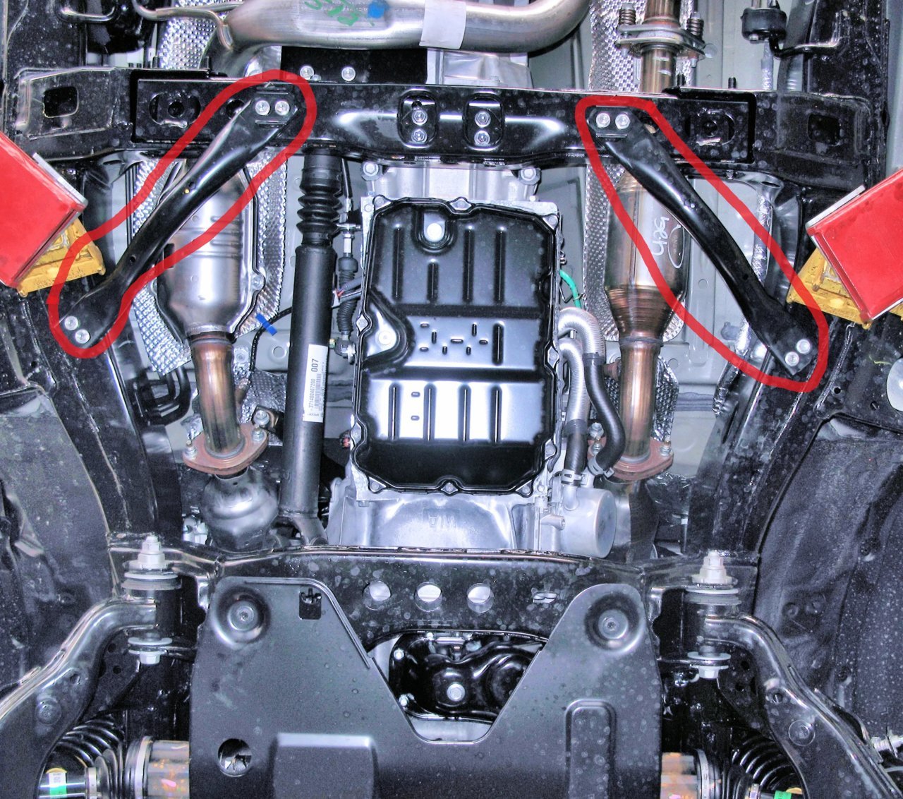

    Can someone help me locate the part # or technical name for these parts (circled in red)?
    I have seen them called cross bars, catalytic converter protectors/guards but I don't know how to order a replacement part. One of mine was damaged.
    Thanks for any help you can give!

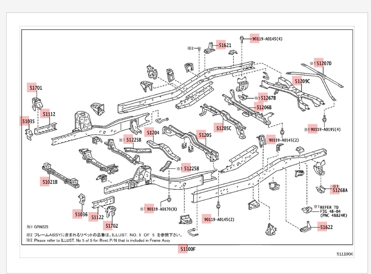

    I think the parts are shown here
    parts.Toyota. com Then click Body and Interior, then frame.

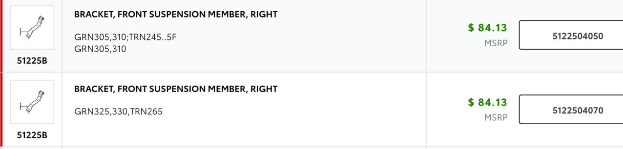

    I believe it's part number 51225-04040,
    Cross-Member Bracket
