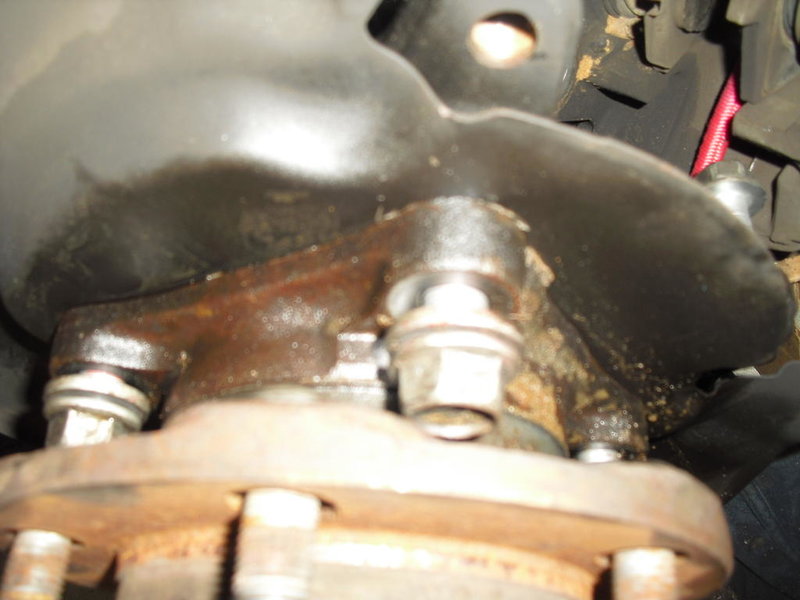

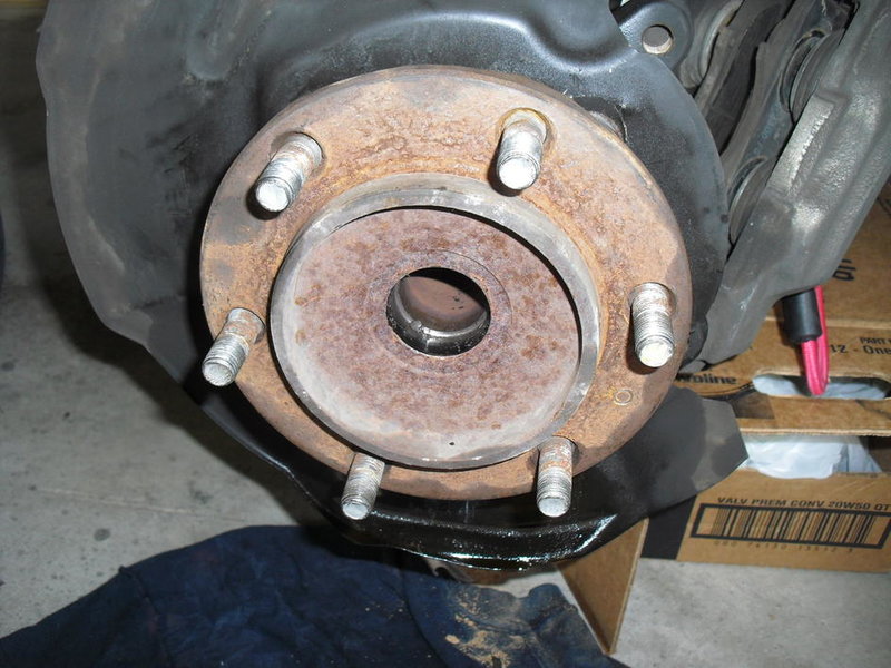

    Hi, so my bearing has basically gone to $hit, i just wanted to make sure, there was nothing else I needed to remove here, before I keep pounding it? I keep hitting it with a 3 lb hammer, and i'm almost deaf, but it won't seem to budge, a lot of the videos on u tube and diy's it shows the center nut and stuff, i'm assuming that's for a 4x4.
    I took off both dust caps, nothing in there, and loosened the nuts, i keep hitting it on the hub, is that safe? or does it need to be on the bearing assembly, any tips for getting it off, it's pretty soaked in pb blaster

    with all 4 bolts loose, keep banging on the hub and fit some pry bars in there to get it to separate some. loosen bolts as it allows. once all 4 bolts are no longer screwed into anything, if you hit the "ear" where the bolt goes through, to the side as to "spin" the assembly it should drop out.
    took me quite a while to get it out on my truck.

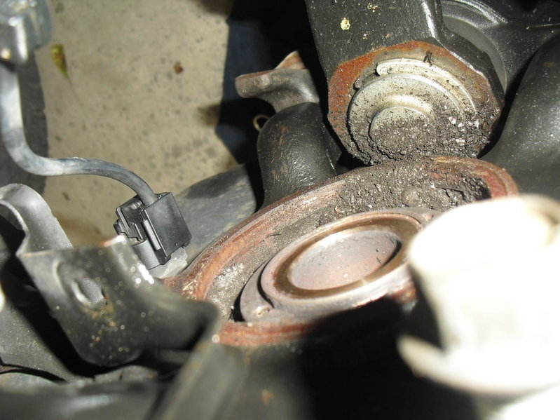

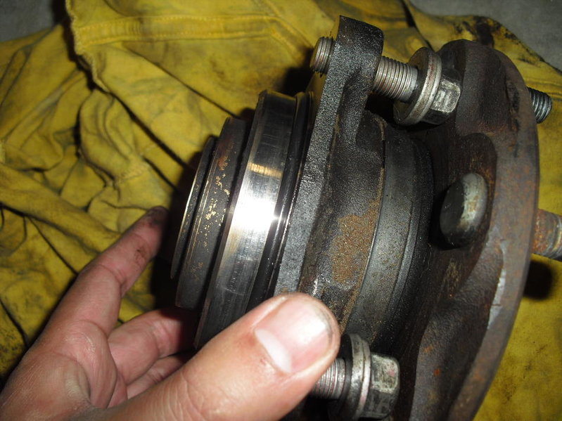

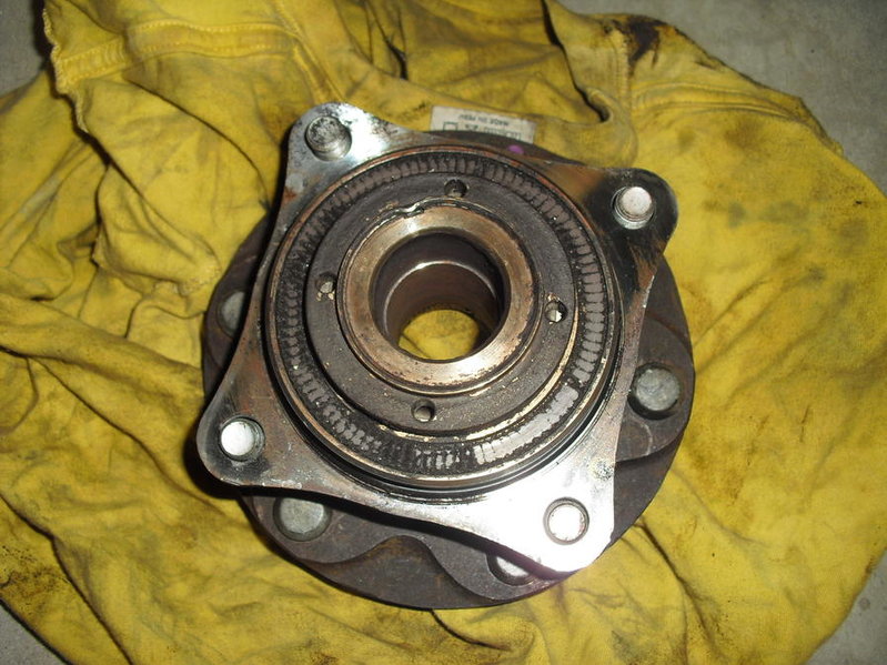

    frontsight, I was asking about seals that need to be replaced in the other thread about hub/bearing assemblies, are is it found in any of these pics? I'm assuming I can buy an assembly, bring this to a shop, they will pull it out, and press the other one in, and I'm good to go? do I need to add any more grease, if so where? and did the dealer charge u 180 just for labor?

    Yes, one seal is on the first pic you posted. I think that's the rubber thing. You can't get to it until you seperate the bearing assemble from the race. See that thing with four holes on the assembly? That's where you need the special tool. Once it it apart you can see the inner seal.
    Once you have the new bearing assembly in hand, you can add grease. Once side of the bearing assembly lifts right off. You will see very cheap white grease. I sprayed mine out carb cleaner- what I had on hand. I then packed the bearings with good red mobil 1 bearing grease.
    Yes the 180 was labor, Toyota is expensive. My mechanic didn't have the tool needed nor did the autozone or advanced auto in my area.

    just an update, looks like everything went well, truck is all back together and seems to ride fine. As for the big specialty washer that nobody can open on the hub/bearing assembly on the prerurunner, I stopped by 4 shops, and they all said they don't have the tool to do it, cept the last one, he put it on a vice, and hit each hole with a chisel and a hammer, and it spun off, so that's one way of going around going to the dealer
