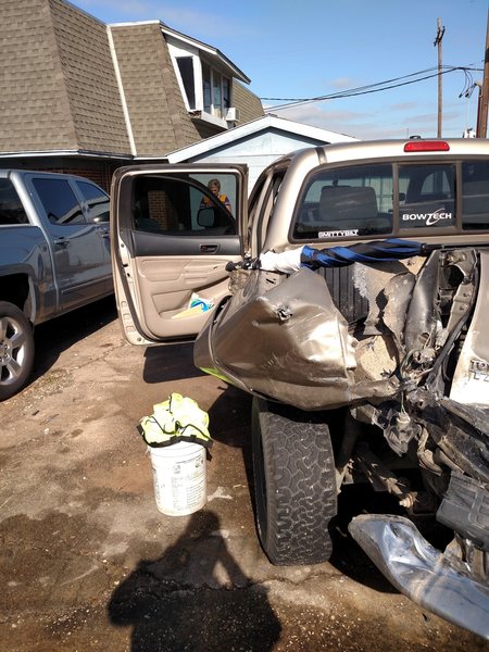

    Man I know where a truck with a good six speed is.

    How much tho?

    I'm still waiting for the insurance, :-(
    You'd have to buy the whole truck.

    If the price was right that would have been fine but it's to far away thanks tho
