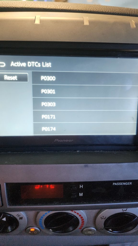

    2006 tacoma v6
    Help please Truck wont idle, these are the codes p0300, p0301, p0303, p0171, p0174. New sparkplugs no vacuum leaks

    Idk if its the maf sensor , vvt solenoids, weak fuel pump, o2 sensors, coil packs, or injectors at this point

    You have lean codes. (for both banks)
    Have you checked fuel pressure?
    I hate noid lights, mostly because the cheap ones can ruin the pin fitment.
    But you might check injector pulse.

    I have not checked injector pulse or fuel pressure
