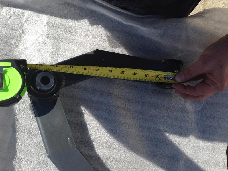

    Can someone please measure from the center of the UCA mounting bolt to the center of the ball joint on your 2012+ all-pro/TC/icon UCA. I think that I was shipped the wrong UCA's and I am supposed to do the lift in a few hours.
    Thank you !!

    10.5 inches

    Yaapp,
    Thanks a lot it looks like mine should be good.

    so 10.5 wasn't good for me. The UCA's push the top of the spindle out so far that I can't even get close to drivable angles. I will be taking out the Readylift UCA's that are 10.5 and try and order the right part. I am going to run my stock UCA's until the correct ones get delivered.
