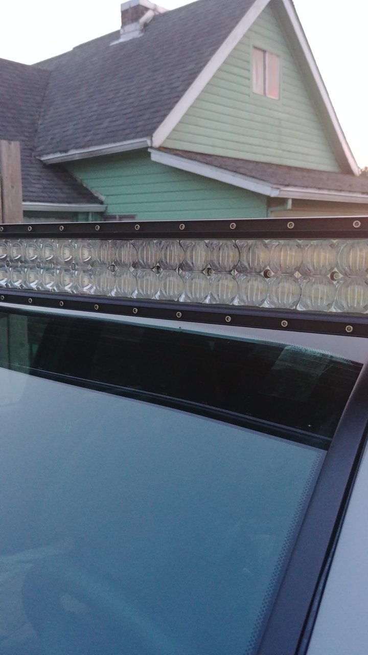

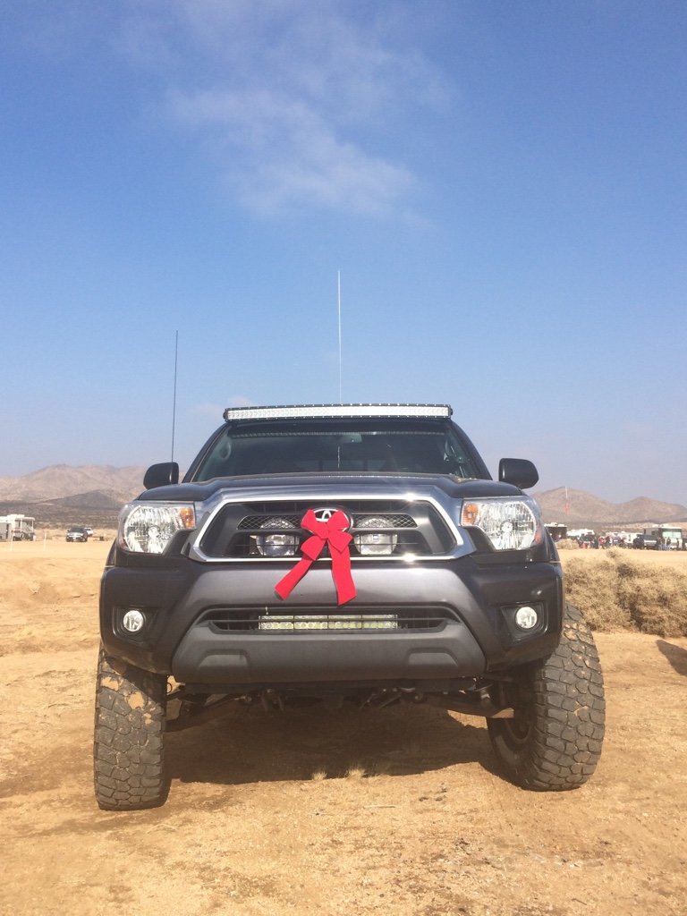

    Too much of a gap between the windshield and bar. I have never had any whistle even in pretty strong winds in Baja. 50" radius bar and TRAC Performance bolt in brackets. 2ac7040eba64e2e5b8e8abd8db2c9357_8b7f1b9cd1001f532837c6bd37bf6b705a4f3bb2.jpg503bfa3524982a5030663da90bc83d79_abaca260837cd42bbbd0e6767f376fefd169ed40.jpg

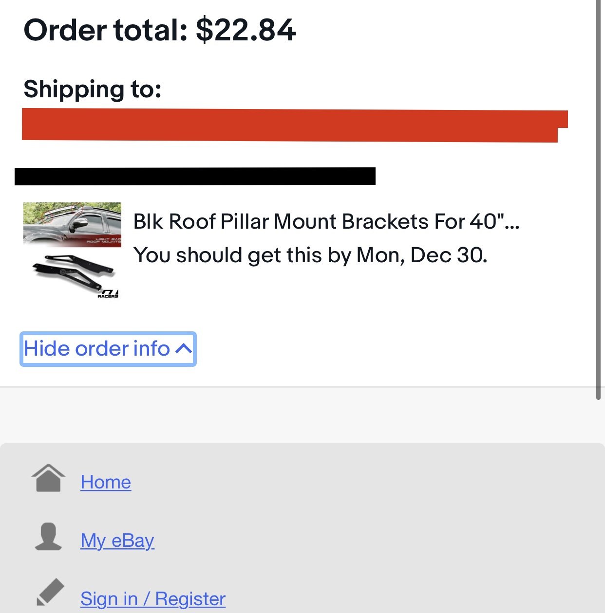

    I have these mounts from eBay:
    and a 42” curved light bar from Amazon. I don’t have any whistling or vibration. I do have wind noise similar to having a lumber rack.
    i put door edge trim on the bottom two heat diffusers it didn’t help with wind noise.

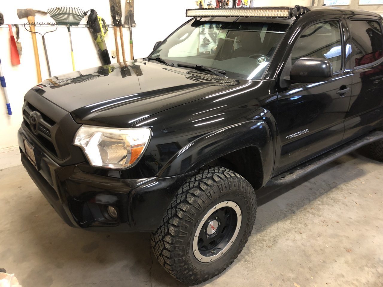

    my light bar is mounted to the oem rack.
    (No whistle/vibs, just wind noise)
