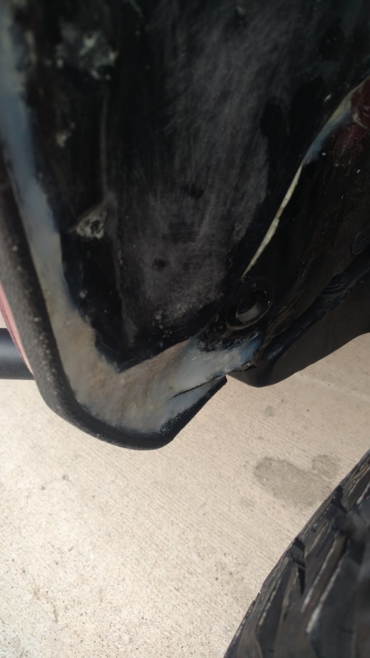

    After I cut the fenders, I actually just made some relief cuts in the factory liners, pulled them up and screwed into the fender.. Was just talking with someone else about this earlier; if you were interested I could dig up and post some pics. I mean it is a build thread :rofl:

    Would definitely like to see some pics if you have em!

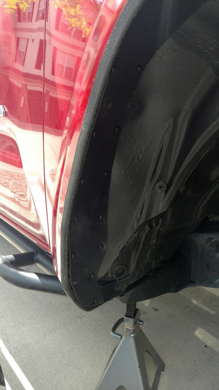

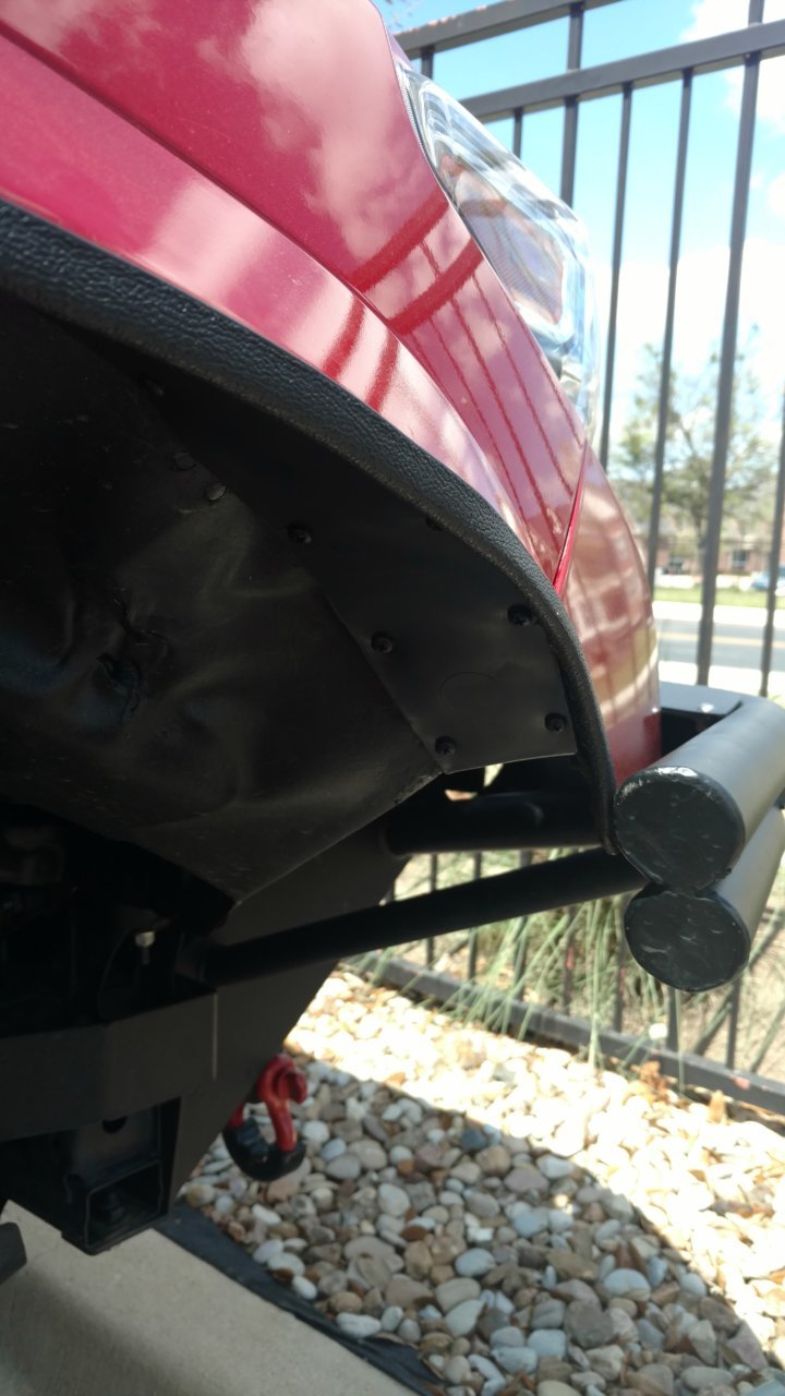

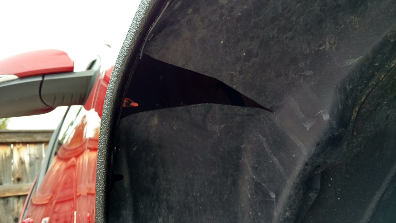

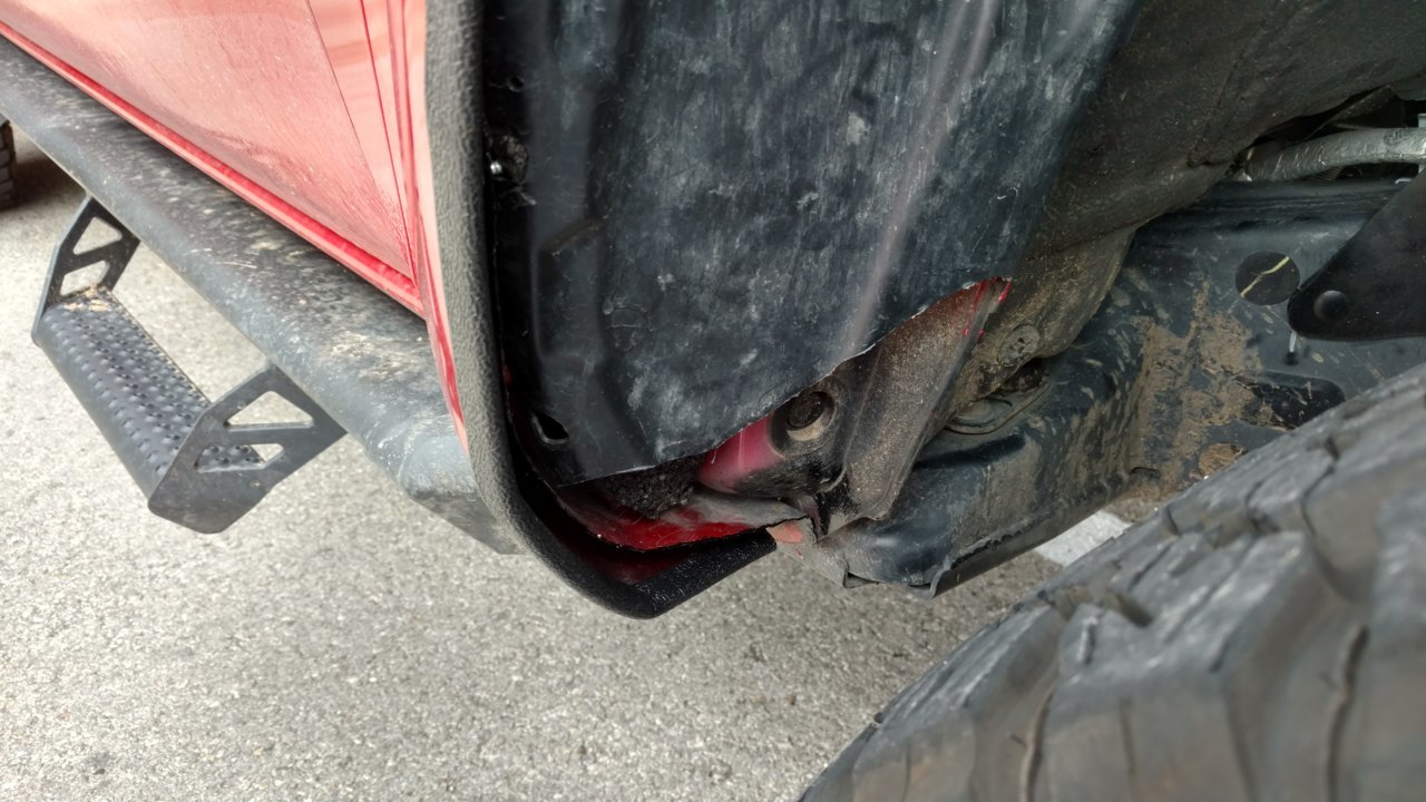

    For sure dude! I've been real bad about documenting anything in the past, but I did snap a few during that process..
    So after the initial fender cut, there was still the gap from where the liners were molded to, and the new height of the fender.. I pulled the liner up in the center, and screwed it into the fender from the inside. You need to make a few relief cuts so it somewhat keeps it's shape, and keep screwing it in every bit till it fits snug all around. I still had to cut some of the outside of the liner in spots, and on the ends..
    Since your screwing in from the inside, you just cut the excess off on the outside and the flare will cover it up..
    Then I went ghetto and just used some spray foam to fill in all the holes, and covered with some silicon so it wouldn't crumble off..
    I caked it after that with some rubber coating, and then just used some abs plastic to cut some strips to cover all that mess up and make it look somewhat decent. Those were just screwed into the original liners
    It's not perfect, but it's a wheel well and gets the job done :thumbsup: I made the flares maybe a half inch longer to cover all that up and even the abs is tucked under there. Gonna have to figure out how to do it all over again here in the next few weeks when the glass comes :bananadead:
