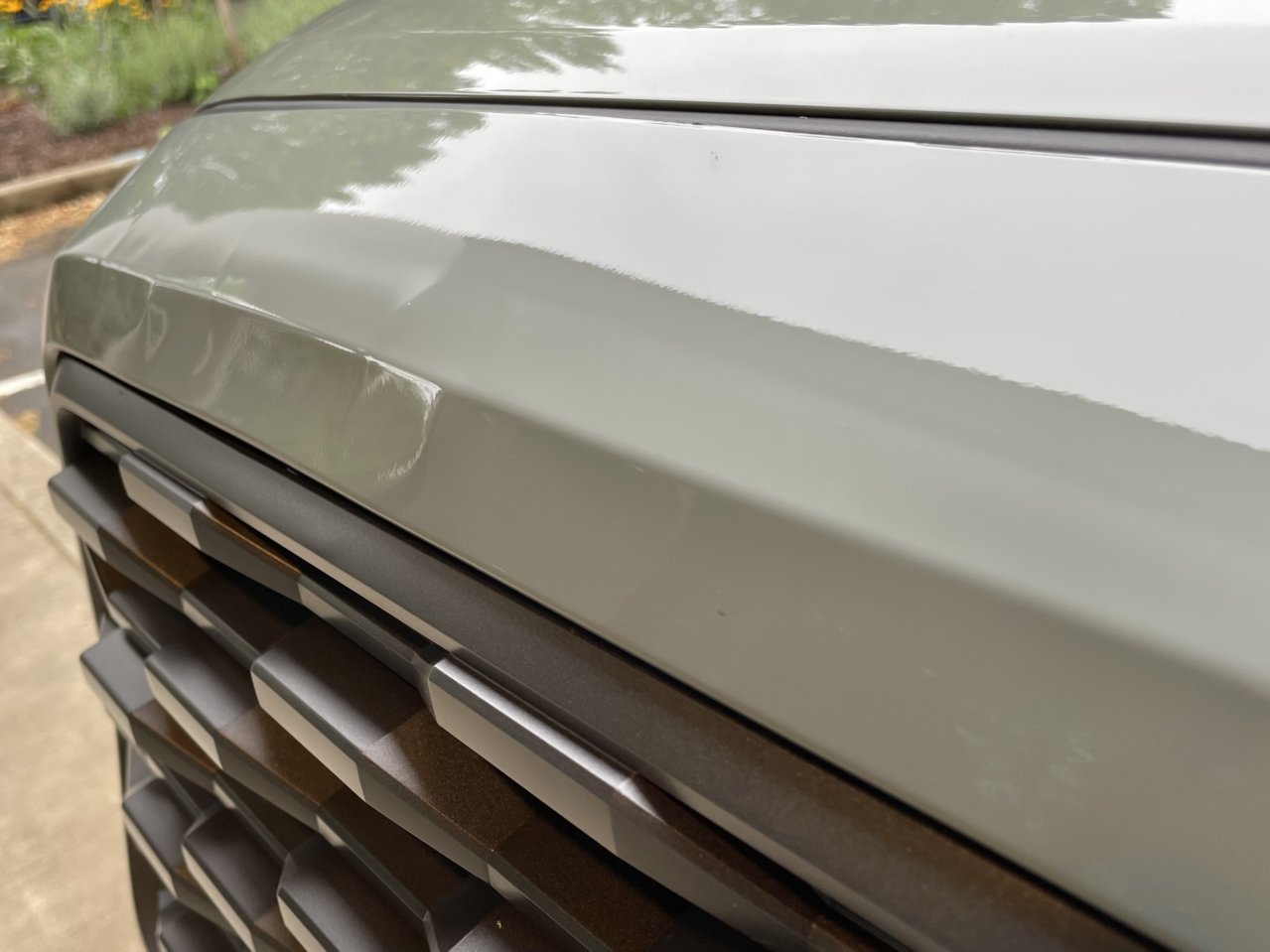

    This happened to my grill surround. On the top portion like shown here and on the narrow strip down below. When I took it to the dealer, Toyota covered the replacement.

    I was cleaning my truck today and I have two spots basically identical on left and right that look wavy. Toyota let their quality control go to crap. I just bought my 2018 TRD OR I notice something out if line and search here and find others have the same issue….

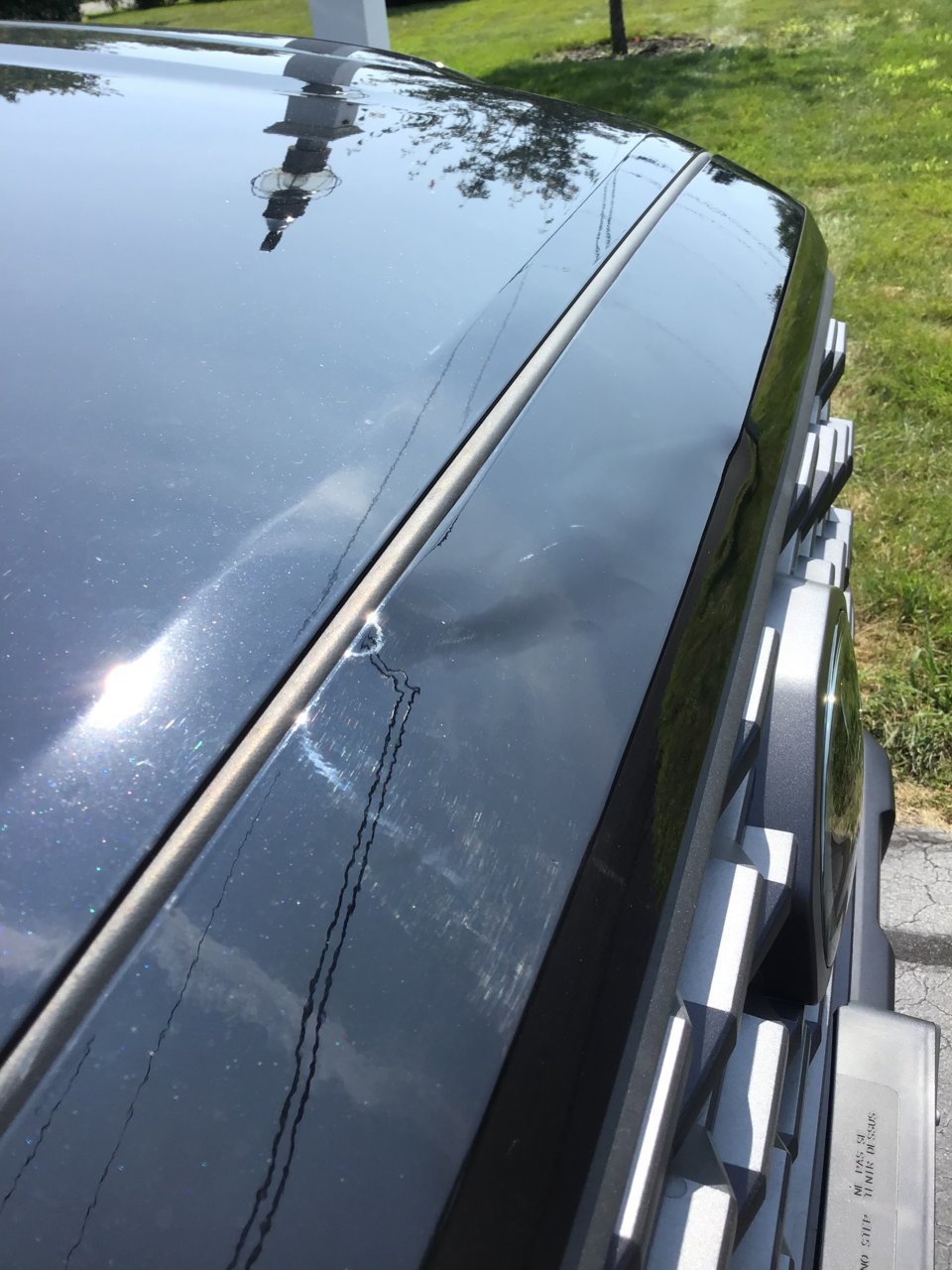

    Just bumping this thread because my grill surround is warped badly as well (will post a pic later, but same effect as seen above).
    Dealer took photos and believes he can get a warranty repair authorized (again, I will update). My truck is 2 years old with just under 18k, so well within the warranty period.
    As an aside, I live in a small town in NH with no glass buildings near me. We have also had a fairly rainy summer, so this isn’t a Southern / Southwestern high sun only type issue. It obviously doesn’t take much heat to warp these things.
    I’m also wondering now how long it takes to create this kind of warping. I’m guessing it could happen while parked in town running errands.
    My opinion (FWIW) is, if it is possible to warp these grill surrounds during the course of normal daily activities, then it is a design defect. Toyota cannot expect the world to change their windows so they can use thinner plastic on their vehicles.

    Here is the photo of my grill surround in the brilliant NH sunlight (I speak in jest as it is only 73° right now and it is August 3rd).
    Somehow that old Violent Fems “Blister in the Sun” song keeps popping into my head.
    This is such a weird failure mode. If it can happen in northern New England, it can happen anywhere. My advice is to be careful where you park.
    I’ll update again when I get my dealer’s response on warranty coverage.

    It's not just from the sun. It is from double paned windows reflecting the sun and acting like a magnifying glass and literally melting the plastic. It happened to mine when I lived in an apartment in South Louisiana. Tall buildings in the city, apartments, even your own hour if it has double paned windows can do it if you park in the wrong spot at the wrong time of day.
    Now my truck is kept in my garage at home and a parking garage while I'm at work. It hasn't happened since. The Toyota dealership replaced mine under warranty.
