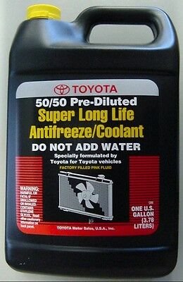

    Toyota.

    This Zerex is good to go!
    @1996_2.4 is your coolant currently red/pink? If it is yellow/green you will want to flush as much as possible before filling it up with red.

    Just get it from Toyota. It’s almost the same price as the auto parts stores.

    It's just like oil, brand doesn't matter. Just check it regularly and change it as needed. No need to spend $30+ of Toyota stuff.

    I heard it's bad to mix red and green coolant. If it's green already stay with that. If it's Toyota red I'd buy more red, from the dealer.
