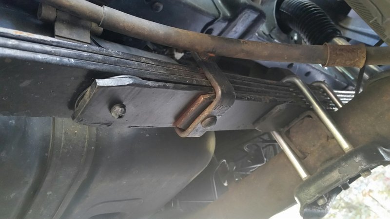

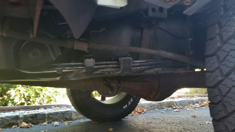

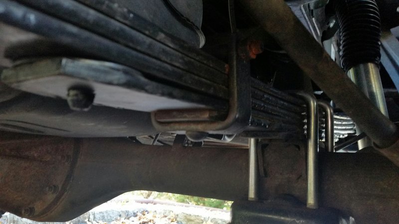

    I have an 05 v6 DCSB. I installed an Icon Progressive 3 leaf pack in the rear and only gained .75 inches on my drivers side and 1 inch on the passenger side. I added them to new spring packs from my frame replacement and have only had them on for about 500 miles... I left the overload out and im not sure why my numbers are so low... I was hoping for 1.5 inches as advertised. Everything is installed correctly as you can see, but these numbers are way too low. Has everyone else got the 1.5 out of their 3 leaf packs (Icon, wheelers etc..)? My measurements are 22.75" and 23" from hub to lower fender. My stock height after frame replacement was 22" hub to fender.

    I plan on putting the overload in, but even then I will only gain a little less than half an inch... Im mad because my 884's gave me too much lift and the icons didnt give me enough. I emailed Icon with pics and they are getting back to me about sending me a new pack.
