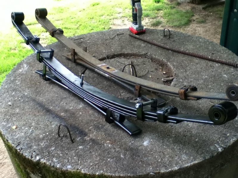

    the one in front has the 3 leaf added with the overload the far one does not and you can see the metal plate that is attached to the overload that's about all that touches between the two. on the far one you can see the rust mark from the bump stop that's not on it but that's about the length of the blocks he had on his. again I'm no expert maybe someone can post a pic of there setup

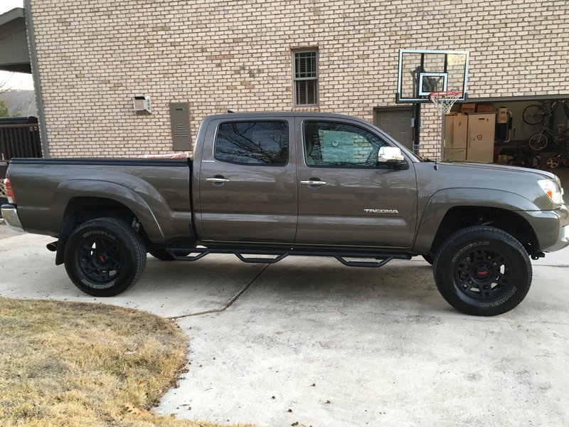

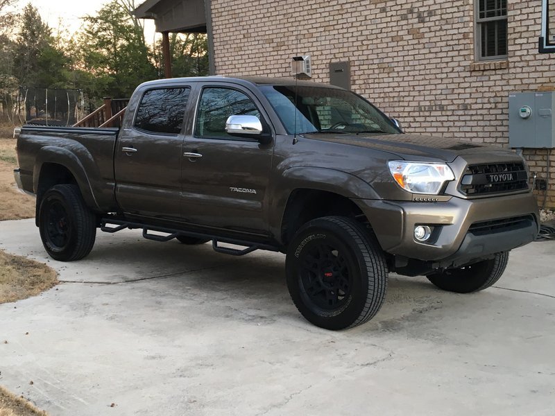

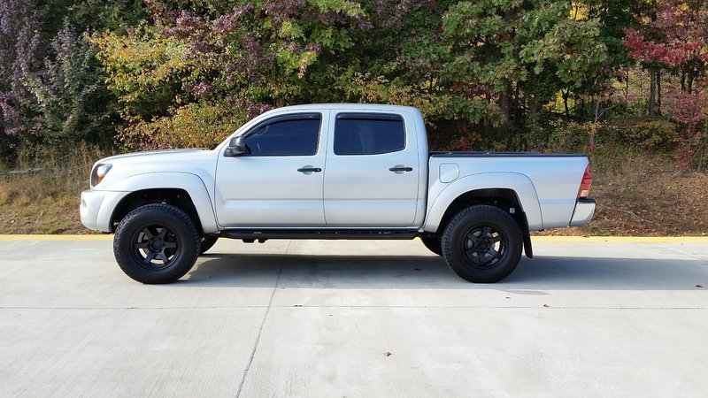

    Mine for reference. rmepilot's setup looks a little bit higher.

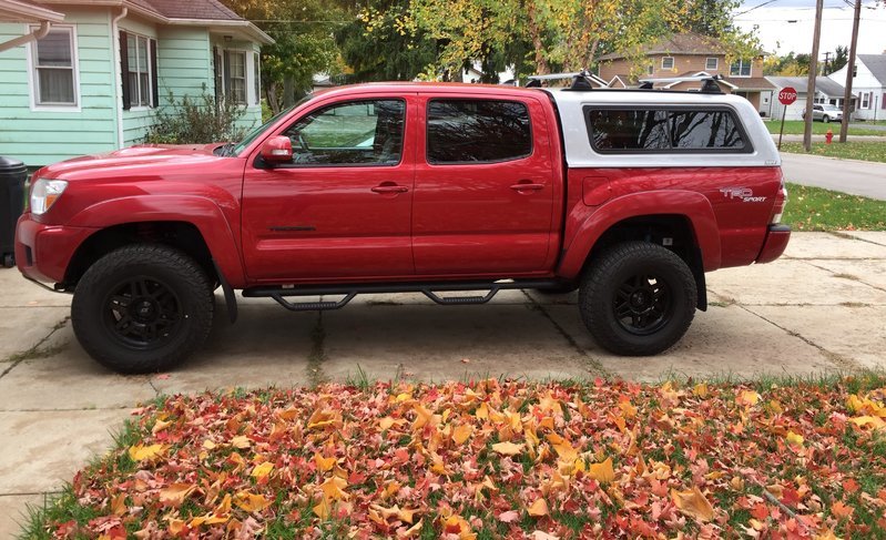

    Here's mine, my numbers were around 24 before the cap, haven't rechecked since it was installed. image.jpg

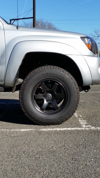

    All your trucks look great. Here's mine, drivers side is only 22.75 from center of hub to bottom of fender.. Tires are 265/70 /17 Hankooks for reference
