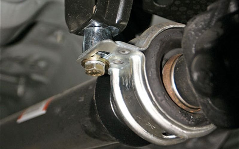

    where do carrier shims go??? it has diff drop installed....sorry to be so dumb. just got this truck and trying to figure out what to do to remedy.

    There's a mount where the bearing ties to the frame... shims go in between the frame mount and the bearing frame.. you get new longer bolts and shims. It's literally 15 minutes.. most of that time will be trying to find your tools.
    See below in the pic (Tundra not Tacoma same thing tho different shape shim on the Tacoma)
    In the pic you can see the new silver shim and new bolt. This changes the angle of the drive shaft.
    As a side note... I think you can tell if its your front 1/2 shafts IF the noise goes away when you engage 4wd.. not positive on that but I think that's what I remember when I was researching my noise.
    Edit: this mod also helps with the axle wrap issue some folks have.

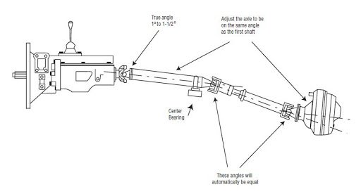

    along the drive shaft. the second picture is just an example, its not from a Tacoma but same idea
