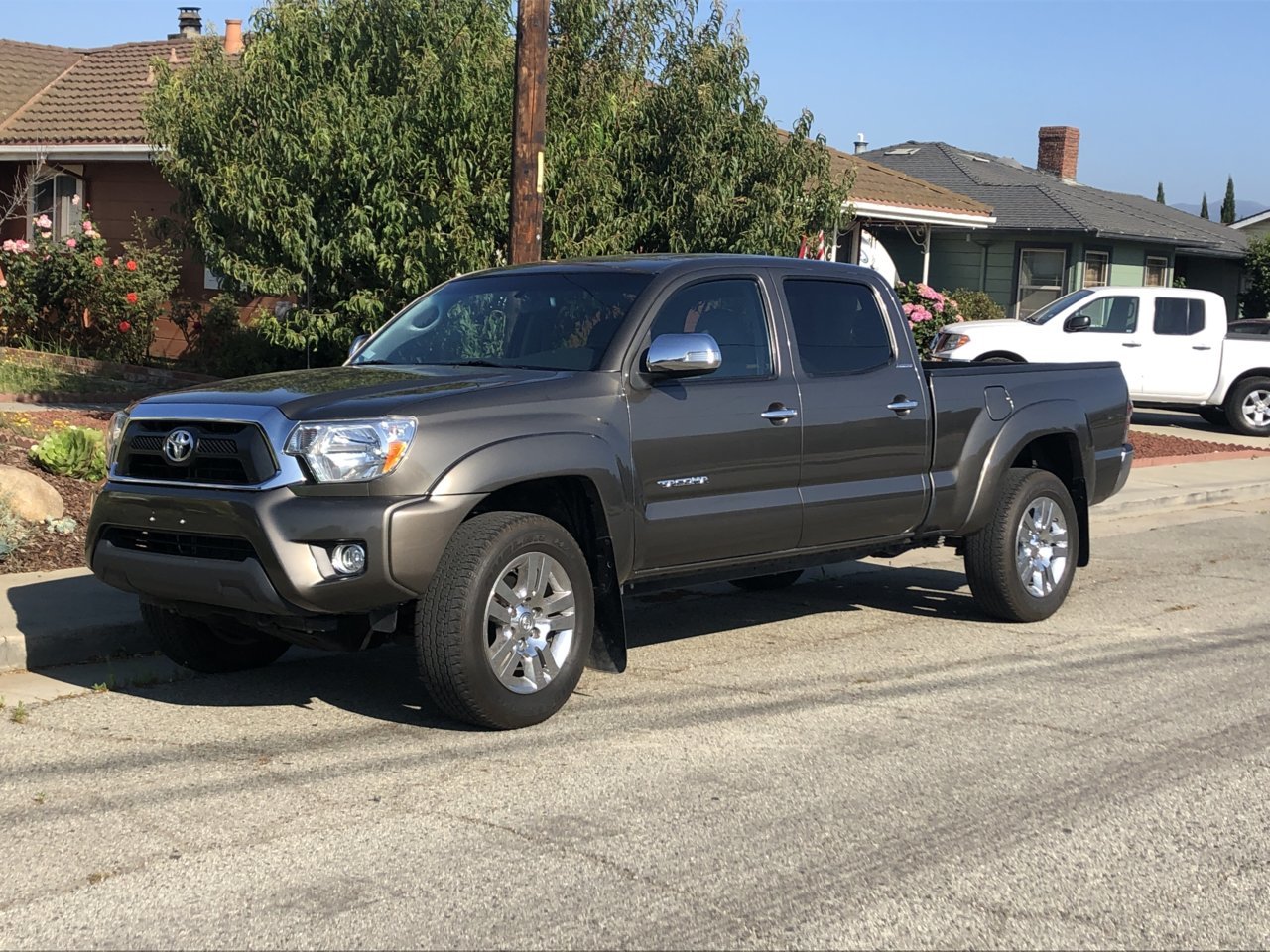

    My stock 2013 Tacoma limited has 18 inch chrome wheels that got to go.
    my question that I need help with is can I get 17 inch Trd wheels and get 265 tires? Without rubbing, or cutting, or having to adjust any brake calipers or anything like that.
    or possibly getting away with 285s?

    Yes. You can run 265 with 17’s. You will rub with 285 for sure.

    265s yes. 285 not without CMC and cutting and or lift

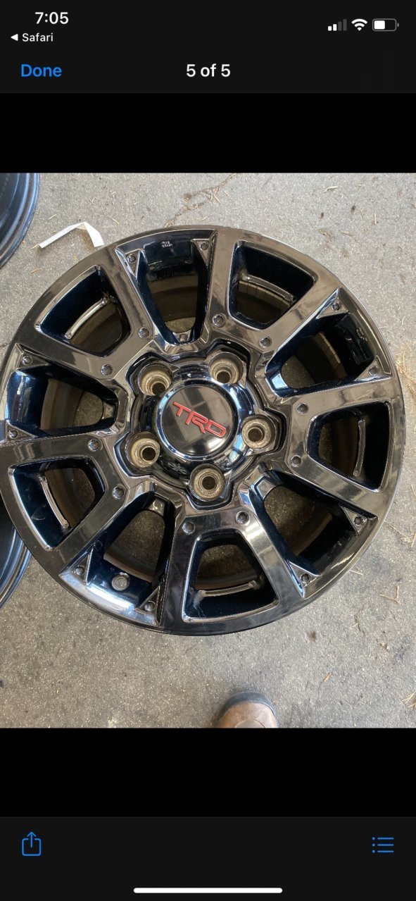

    If the truck is stock, 285s are a no go. The pic of the trd wheel shown is a 5 lug and you need 6!lug wheels. You can run a 265/70/17

    What he said ^^^. Your truck is a 6 lug, don't buy 5 lug rims. Nice truck, welcome to TW. :hattip:

    Appreciate the welcome!I’ve been wanting to join the tribe a long time haha.
    And Damn! I didn’t even notice it was a 5 lug in the picture my buddy just sent me those and i got all jumpy, thanks for calling it out!
    yes truck is 100% stock at this point but i eventually will get my coins up and lift it maybe 2in., But a thats just a little down the road. Or should i do 3inchs?
    so 6 lug, and i need to look 265/70/17s
    i appreciate all the info guys
