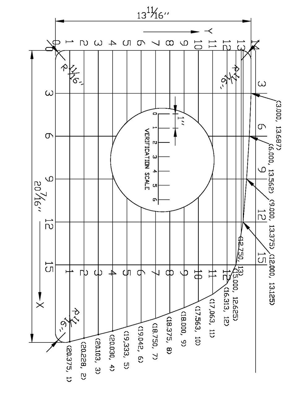

    Taking a change on a short distance haul of a heavy bulky load cost me a smashed left rear window on my 2008 SR5 Tacoma.
    Finding completely rediculous the $1000+ that the Toyota dealer wanted for replacing the whole rear window assembly (about half at windshield replacement specialists) I set out to make one out of tinted plexiglass. I measured precisely using X-Y coodinates the existing good window, I then made an Autocad drawing which I printed, pasted onto the plexiglass panel and cut using a band saw.
    I then glued the plexiglass onto the remains of the old window and except for the application of the caulking at which I'm not so good, it looks fine...all for less than $50. Drop me a word for the drawing and details

    Of course, my first intention was to completely remove the old glass and insert the "plexiglass" in the groove....but that is mission impossible. The glass adheres so hard to the rubber that I really can't see how removing it all could be done.
    I Used the Mulco Flextra to "glue" the plexiglass onto the old glass and polyurethane for the fine sealing job.
    I wrote plexiglass but the actual product is : Evonik industries ACRYLITE FF bought at the local hardware store.

    For those who would like to replace this window, here is a photo (pdf drawing file converted tp jpg) which provides all the X-Y coordinaltes required to reproduce a full scale tracing.

    Did you use plexiglass or lexan, lexan is alot tougher and runs around 165.00 per sheet, i think plexiglass will start bowing out after it gets the heat build up in the cab

    Hi Kotah, here is what I wrote on a 2015 post:
    "I wrote plexiglass but the actual product is : Evonik industries ACRYLITE FF bought at the local hardware store."
    It's been 2 and half years and the window is holding up fine.
