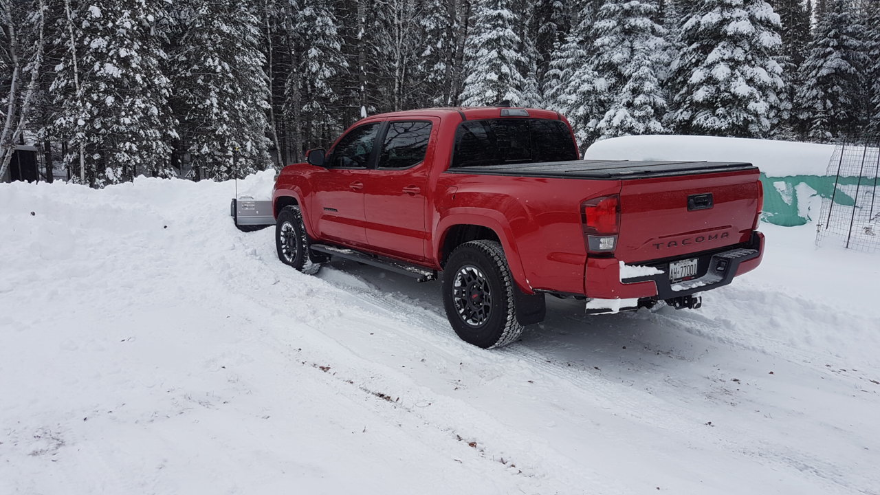

    Second year with a plow on my third gen. Works great. I think its call s Snowsport plow. Its light, simple to use and strong.
