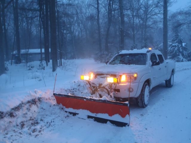

    I like the dolly, may totally need to build myself one of those ... what brand of plow is that ? .. and what I think I meant was the push plates.. the add-ons to the truck side that attach to the plow .. it looks like the new Fisher HS plow , the push plates are really low and drastically cut into the clearance of the truck when the plow isn't attached. Some other folks had mentioned that if the push plates are too low, it'll effect my offroad clearance .. not that I go crazy .. but do like to get off the pavement to hunt and fish .. AND that if they're too low, it'll effect the ability to backdrag and make it more likely to get stuck.

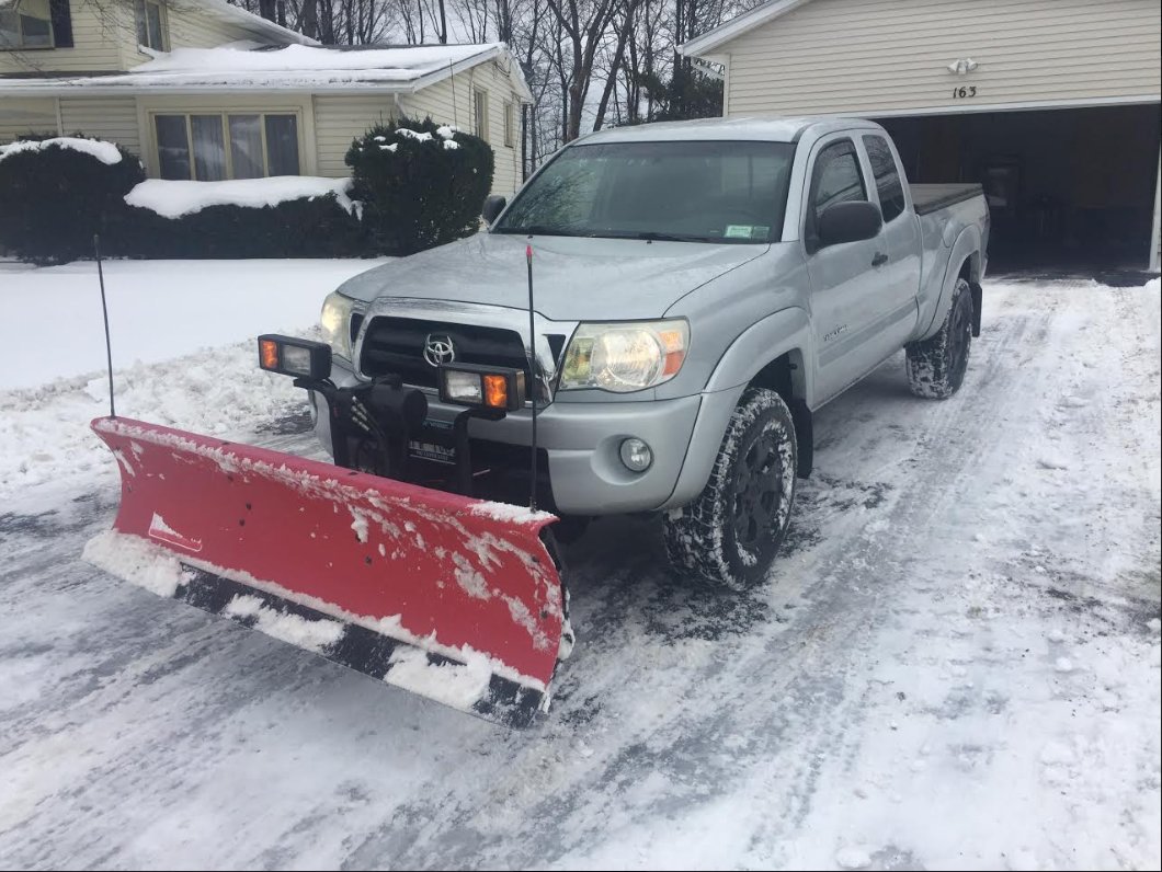

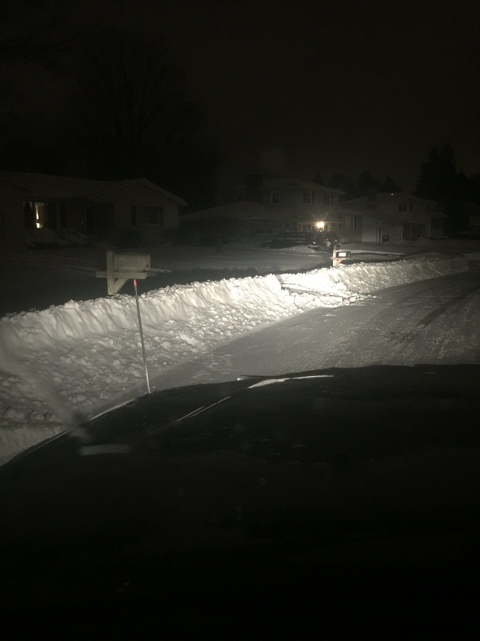

    My Driveway when I got home from work on Saturday after a storm dropped a foot or more of snow on us. The town plow trucks had left me with at least 2 feet of snow in the front.
