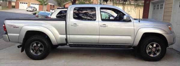

    Ok all, with all the research and all the suggestions. I went with the Cooper Discoverer ATPs. The price was right and it had the beefy look I wanted. So far I am very pleased with my decision. My ride is actually smoother and grabs the pavement much better than my stock dulers. Also my concern was if they were loud. They were compared to the stocks. Not much different. I would recommend these tires to anyone. Finally I got my FJ SE Wheels put on and went with 265/75r16s. Super Happy! thank you all for the input!!!!!!
    Here's a couple of pictures.

    Good choice and nice wheels!

    Very nice wheels!
    Good job on the tires also,
