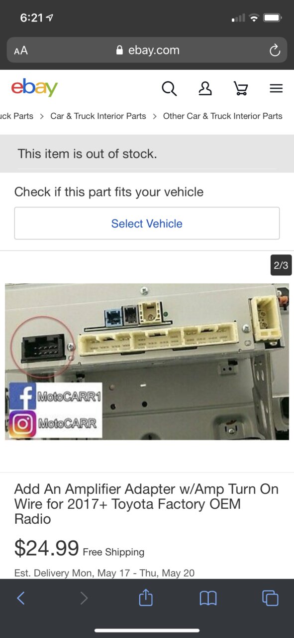

    I'm sorry if a thread already exists on this but.. is there a plug and play adapter available to add an aftermarket amp to the 2021 non JBL head unit?

    Sub amp or multi channel?

    Sub amp. A single 10

    Ehhhhh, you sure about that?

    About if it fits? Or it’s quality? Lol
    more sure of the fit, quality is probably crap. But he wanted plug-and-play so it fits the bill

    It's out of stock anyway

    2020 and up have different stereo plugs

    The one I linked to also works on 2021, too bad it’s sold out

    idk, if it was me, it'd purchased the pnp connectors for a 4channel amp and sub. You might decide to add on a 4 channel amp down the road

    Yeah, fit mostly. That wouldn’t have worked on my 2020 4Runner, the speakers were on their own connector. IDK when it changes over and if the same rules apply to Tacoma however.

    Yeah this one is for the toyota radios with the speakers separated (the 70-1765 harness.) that’s also why it has the add-a-fuse for the remote turn on

    Looks like I was thrown off by the wire colors. It looked like power, acc, ground, illumination, remote/antenna and two speaker channels when I looked at it. I sorta disregarded the connector once I latched onto that.
