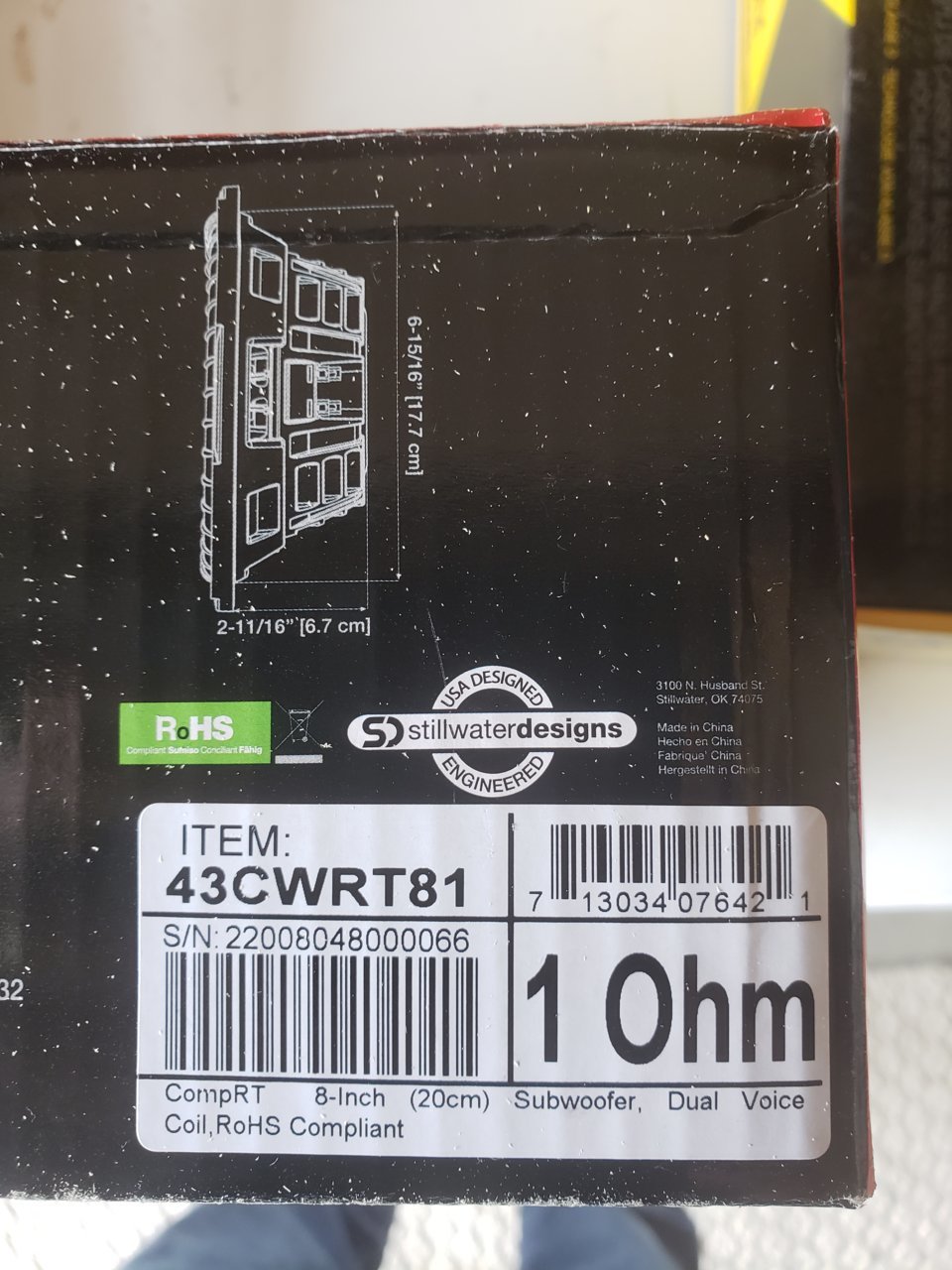

    Hope that's the dual 1ohm sub!
  4. Nov 2, 2018 at 12:14 PM
    #24
    pdxptw
    pdxptw [OP] Well-Known Member
    Jun 6, 2018
    #255665
    146
    Patrick
    Denver, Co
    2021 TRD PRO 6M
    Well, shit. I dont know. I asked the guys at crutchfield what I needed and this is what they sent me. It says dual? I can still return if needed as I just started cutting MDF.

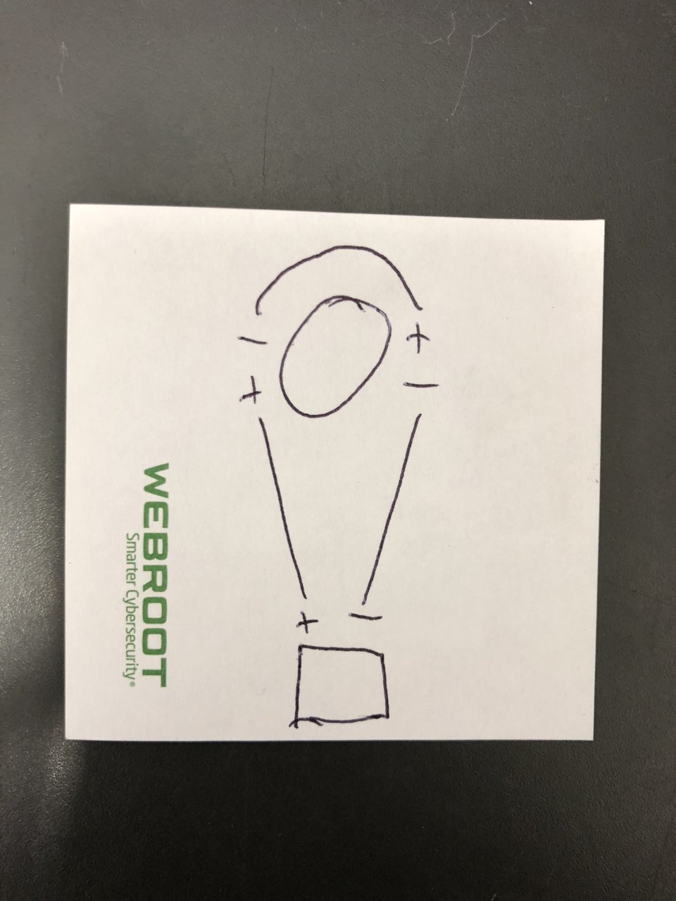

    You’re good. You’ll want to wire it in series
    Hopefully this very crude drawing makes sense

    Gotcha, thanks!

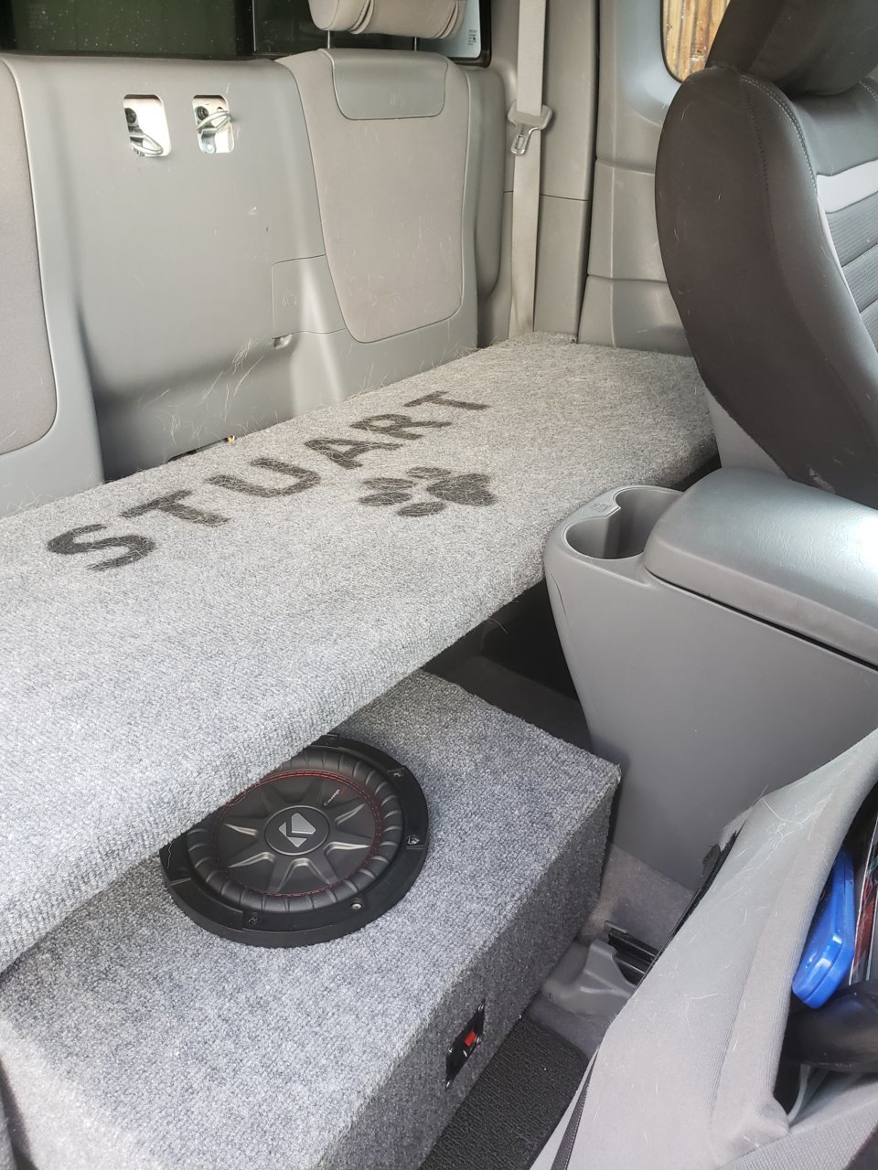

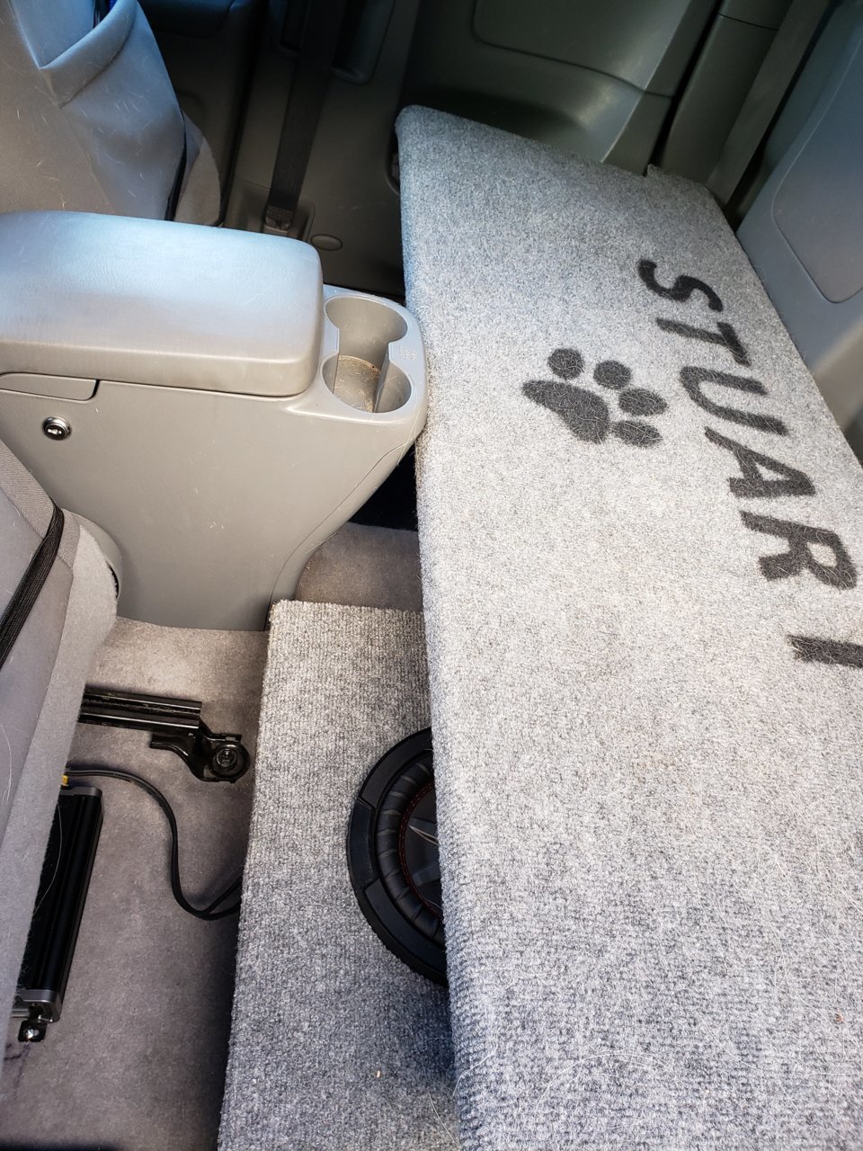

    Ok! Box done and wired properly thanks to u/destin_meeks.
    Fits great under the dog platform. In retrospect I probably could have gone with a 10" as I'm right on the volume capacity limit for the 8.
    Can't wait to wire up the amp and get this thing going tomorrow.

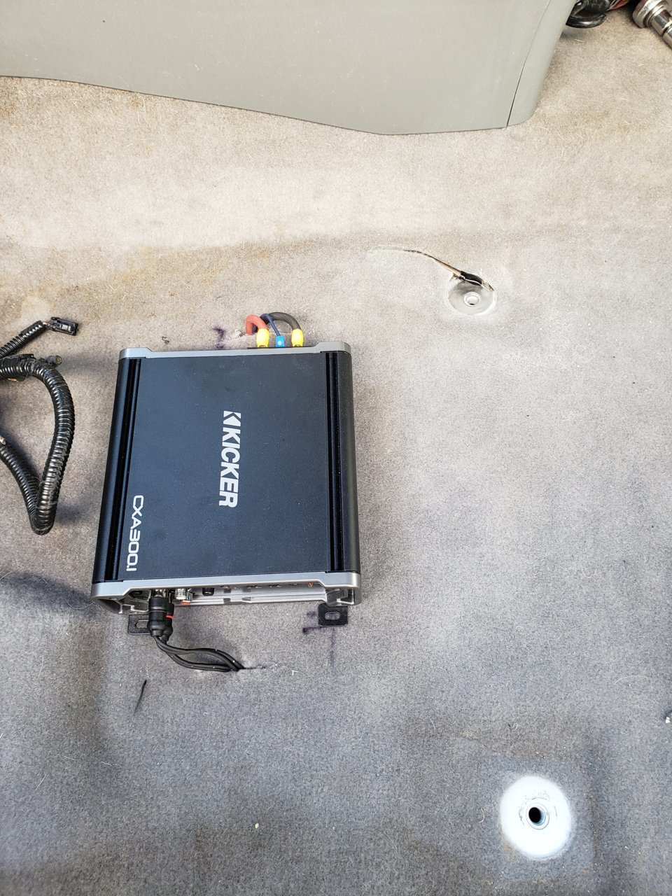

    Hmmm, looking at amp wiring.
    Going to tap into existing sub wiring, should I just wire together the black/red for + and the Y/W for Neg as I only have one RCA input on the amp?
    Thx.
  9. Nov 2, 2018 at 4:10 PM
    #29
    destin_meeks
    destin_meeks I used to fix people's crappy stereos
    Jul 14, 2017
    #223997
    3,944
    Destin
    Tuscaloosa, AL
    2017 SSM DoubleCab TRD Off-Road 4x4
    The amp has 2 RCA inputs. White and red. However, you only need one. But if you choose to only use one, do not combine signals. Use either the left or the right. Touching those pairs together might short out the radio.

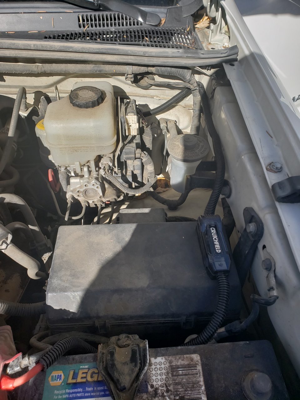

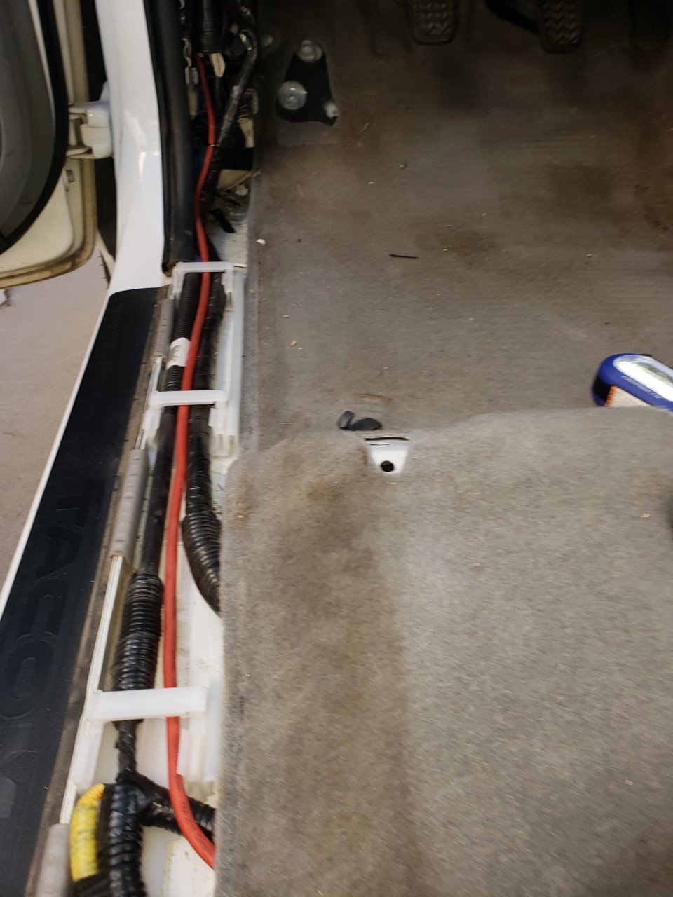

    Finally finished!
    Ran the amp power through the small grommet on drivers side firewall.
    I have a 6M so I think it's important to note to immediately head to the sidewall with the power wire once its through the firewall as it comes out right above the clutch assembly.
    Mounted under drivers seat, tapped into existing sub wiring.
    I will note I placed carpet patches where the wires crossed the sharp bare metal to protect from wearing.
    Only thing I can't figure out is now I can turn my head unit on with no key in ignition. I wired the remote as indicated and left the last 2 wires (brown, white/grey) uncut on the existing sub harness.
    Aside from that is was super easy and sounds killer!
