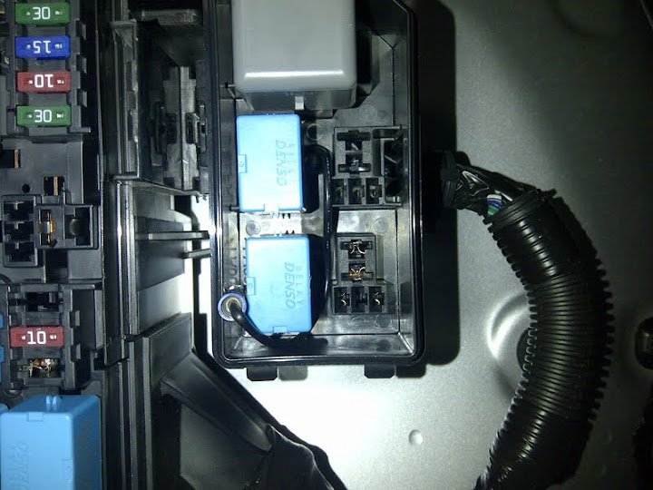

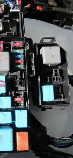

    Have you verified the small box attached to the main fuse/relay box in the engine for the required pins to the fog relay?
    Post a pic...

    This is not part of your vehicle? (the box)

    Nope; looks like the 2015 without fogs didnt get the box.

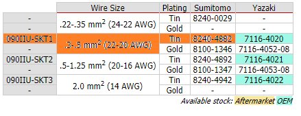

    This is pretty cool, just a few bucks the terminals including postage. I don't see the exact same part number on the Corsa site. Closest that I see for 16 ga is 8240-4892; for 14, 8240-4942. Your advice?

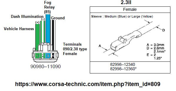

    20 awg is the OEM wire size on the fog switch.

    I found the oem parts numbers from your drawing on the Toyota parts page. Looks like they add a bunch of dollars to the parts. Do you need the 90980-11090, which I take it is the socket that keeps it all together?
  17. Nov 9, 2020 at 2:41 PM
    #17
    caribe makaira
    caribe makaira Well-Known Member
    Feb 13, 2011
    #51121
    11,724
    Caribbean, Puerto Rico
    05 PreRunner TRD Offroad AutoTrans
    Hood Struts, My version Fogs always ON, Map & Overhead Light Mod,
    That is the connector that houses the terminals and attaches to the switch...

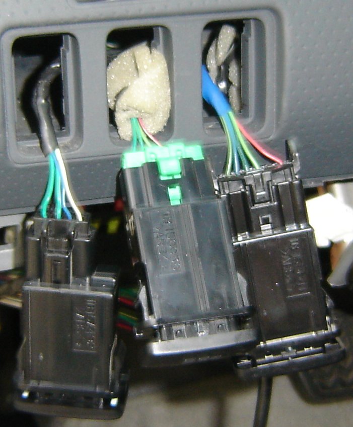

    What’s the plug to the far right of the 3 on top . I have that on my access cab connected to a blank . Was looking for fog light harness
  20. Apr 16, 2023 at 5:36 PM
    #20
    caribe makaira
    Feb 13, 2011
    #51121
    11,724
    Inverter Switch.
