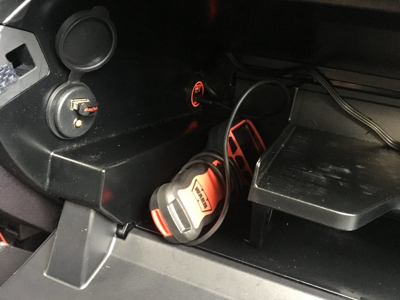

    Move USB port to glovebox tonmake room for a dual battery gauge, and added a dual usb charger to the glovebox to permanently charge my warn remote and power my crux/phone.

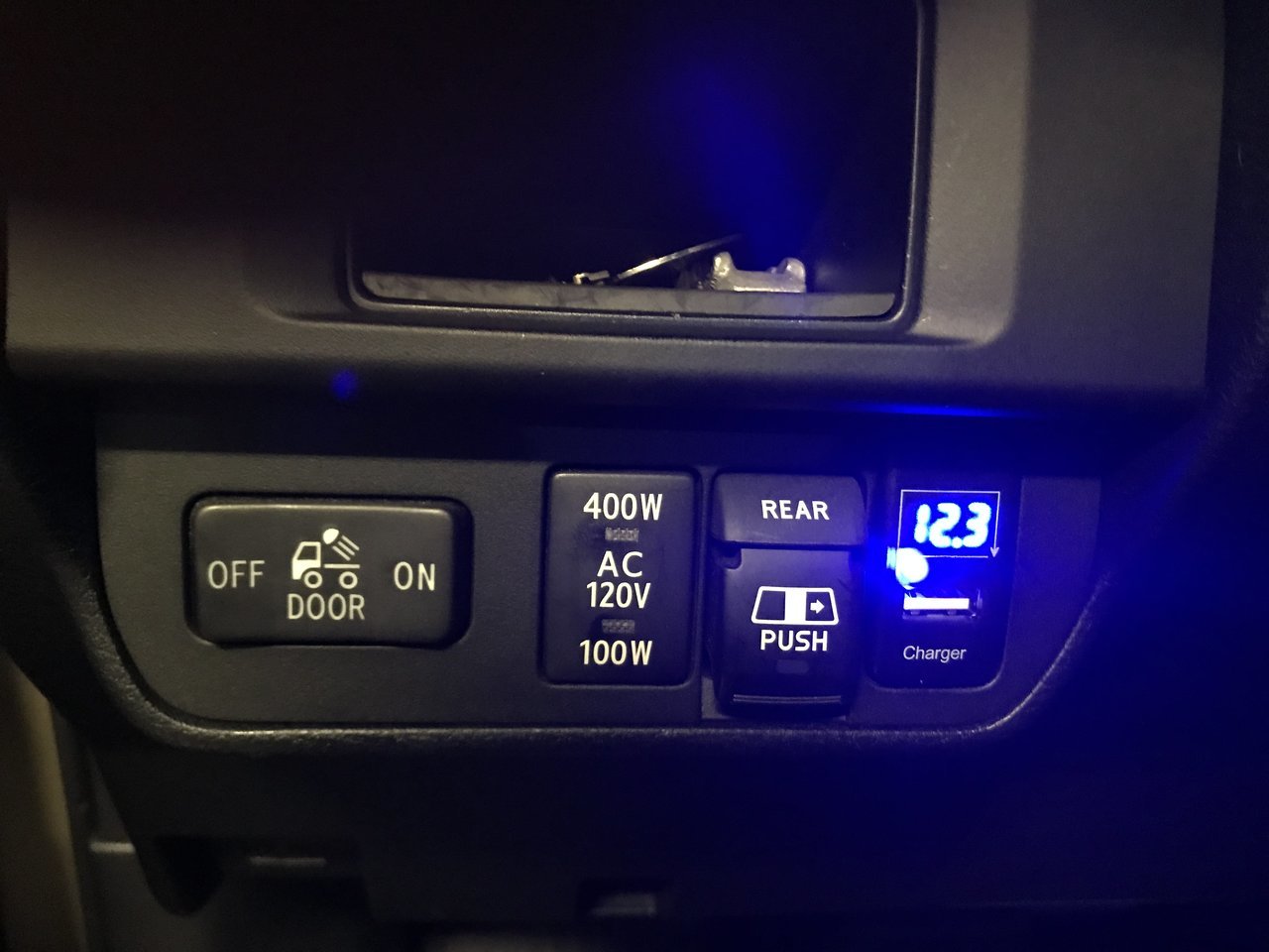

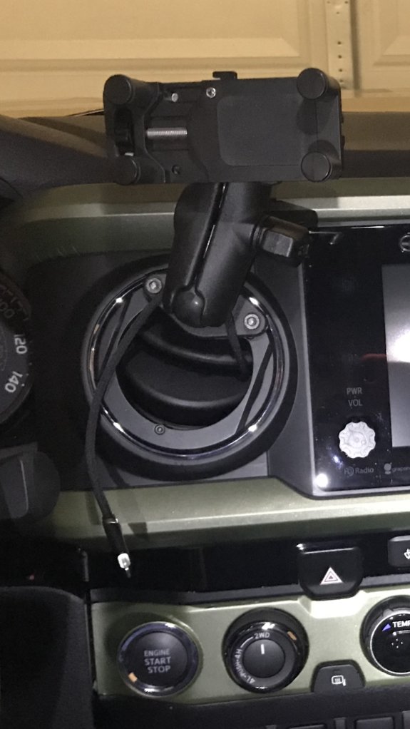

    Do you mean a voltmeter? I added one to the left hand side, next to the rear sliding window button. Handy for the day I want to temporarily add a gps or similar device to the driver corner of the windshield and not have wires dangling thru the center of the dash. I hard wired a dash cam and ran a hidden charging cable thru the vent so this extra port will rarely get used but I like having it just in case. D41CE11B-4F2A-4D32-BCDD-4AA8BF91CD7B.jpg CCAF2547-A806-40DC-8DA2-B83B75D3DA48.jpg

    Yes, ch4x4 has one in the taco small switch size.

    Yes- the 3mm and USB port is in the front, the 2 5v usb charger is the illum in the back.

    That’s what I used. It extends both the usb and the 3mm jack in the plug.
    You can see the 3mm plug in the pic above.
    I used a $12 2 usb red illum jack in the back to keep my winch charged
