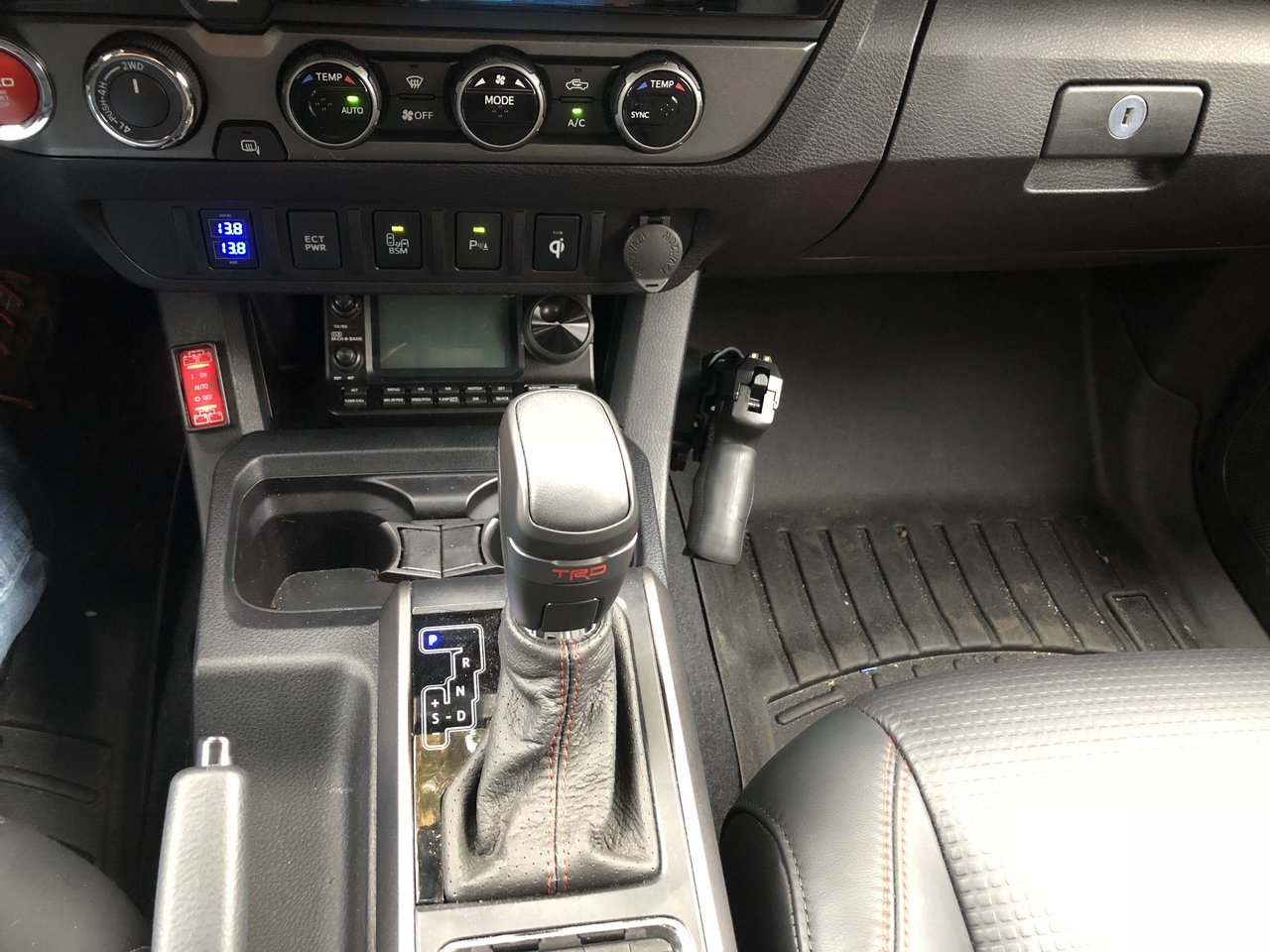

    So you just popped the switch out and plugged that rear connector into it?

    Yep- I popped the oem usb/3mm plug back into the dash and zip tied it- freeing a slot for a switch.
    Because of that I was able to install my blue dual battery voltmeter. I then cut a whole in the trim and installed the dual battery controller left of it. Super clean.

    Updated pic

    awesome thanks man, just what I was looking for
