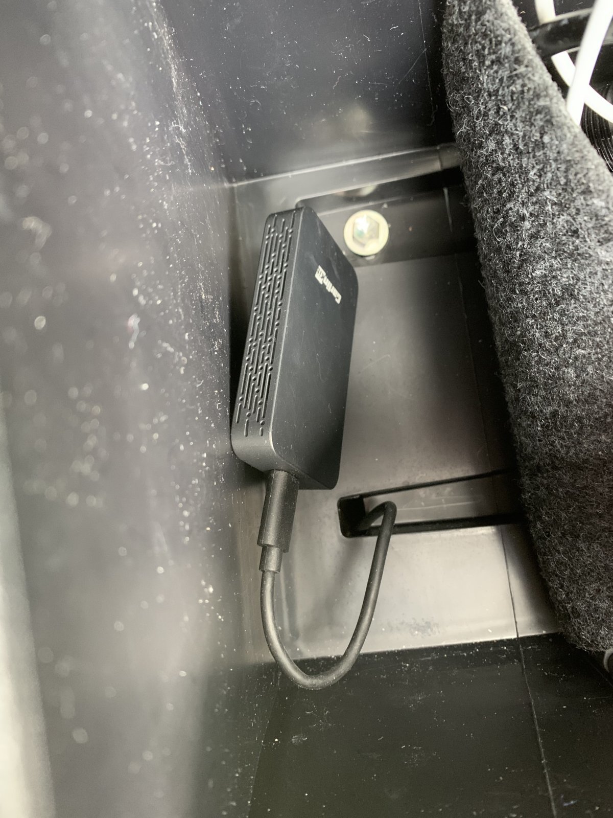

    Hello everyone,
    I am relocating the media port of my Entune 2.0 radio and have found this cable which would simplify everything! I have not yet received this cable, but I have done my homework, I hope. The cable is listed for a 2017 Sienna which had Entune 2.0 before the Taco. The sienna radio is listed as interchangeable, and I am hopeful. Please have a look at the connections and post anything you might offer. Unfortunately, no length of cable was listed but it seems from the pics as adequate. Thanks for listening!
    LEEWA Car Audio USB AUX Interface Adapter for Toyota Corolla Camry Highlander Sienna RAV4 Prius AUX Cable #CA7160 (aliexpress.us)

    I received the Leewa cable that I had mentioned above in record time and it works! It was designed for another vehicle so I can't quite figure out what to do with the 3.5mm part of it but no matter, it is long enough to relocate the media port for the Entune 2.0 radio to the center console. This will make me very happy when I replace the head unit and setup wireless CarPlay.

    Bought a similar cable and works great. This allowed me to bring the connection for CarPlay all the way back to the arm rest box. There is a hole at the bottom of the arm rest box that I fed the USB cable through so no drilling or cutting of the box was necessary.
    Paired this up with the Carlinkit (wireless CarPlay). I couldn't be happier with CarPlay auto-connecting when I jump in (most of the time) and the cabling out of sight.
